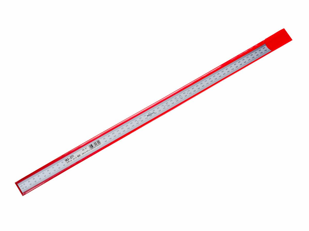

Full Flexible Steel Rules
The Mitutoyo Full Flexible Steel Rules provides highly accurate length and other linear measurements on a fully flexible steel ruler.
The Mitutoyo Full Flexible Steel Rules are constructed with tempered stainless steel to ensure accuracy of length measurements and provide better durability for a longer instrument life span. The clear graduations on the satin-chrome finish assists with measurement reading.
  • Available in many different sizes, graduations and widths
  • Graduations are easy to read
  • Full-flexible rules are 1/64” thick
  • Constructed of tempered stainless steel
Order No.: Product Image: Size: Graduation: Width: Accuracy:
