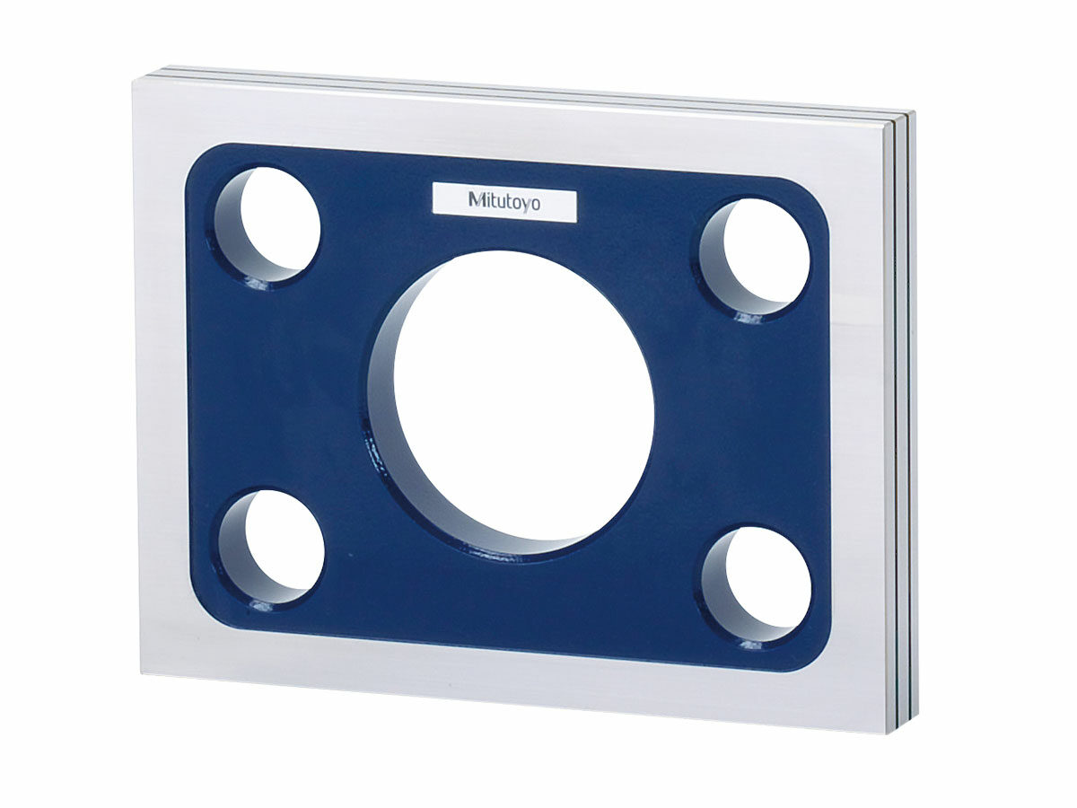

High-Precision Square
The Mitutoyo High-Precision Square is ideal for inspecting high-precision measuring instruments for squareness and straightness with ultra-high accuracy.
The Mitutoyo High-Precision Square is used as the reference for inspecting the accuracy of high-precision measuring instruments and XY tables, such as the straightness of each axis motion and squareness between motions of two axes. The squareness and straightness of the four reference surfaces and two side surfaces are finished with ultra-high accuracy.
  • Available in Metric only
  • Available in three different sizes
  • Four precision-lapped reference surfaces for ultra-high accuracy
  • Better than 1µm/300mm straightness and perpendicularity
  • Supplied in fitted wooden box
