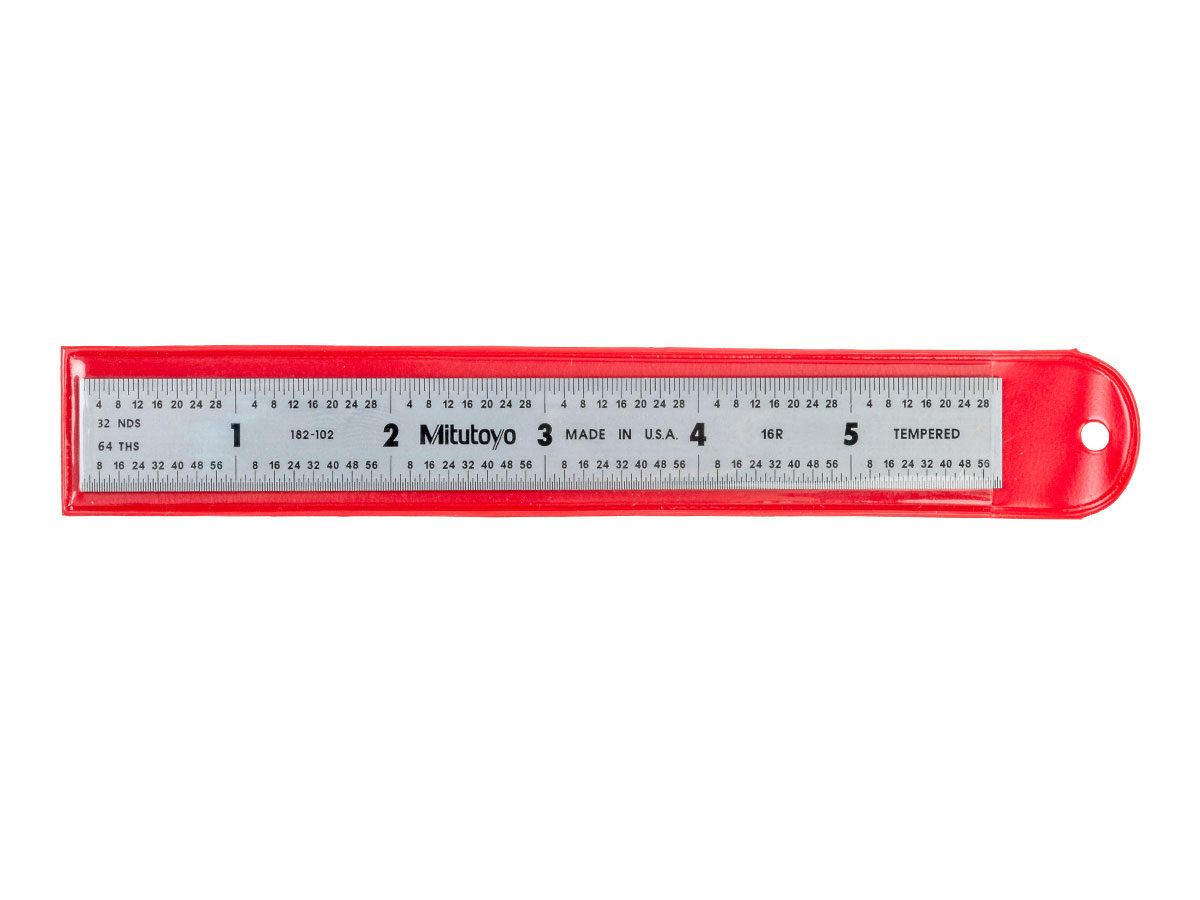

Wide Rigid Steel Rules
The Mitutoyo Wide Rigid Steel Rules provides highly accurate length and other linear measurements.
The Mitutoyo Wide Rigid Steel Rules are constructed with tempered stainless steel to ensure accuracy of length measurements and to provide better durability for a longer instrument life span. The clear graduations on the satin-chrome finish makes measurement reading easier. The rigid steel rulers are designed to not flex.
  • Available in many different sizes, graduations and widths
  • Graduations are easy to read
  • Ruler thickness is 3/64” for rigidity
  • Constructed of tempered stainless steel
Order No.: Product Image: Size: Graduation: Width: Accuracy:
182-101 - 6”(4R) 1/8 1/16 1/32 1/64th 3/4” +.004"/-.0035" (+0.1mm/-0.09mm)
182-102 - 6”(16R) 1/32 1/64 1/50 1/100th 3/4” +.004"/-.0035" (+0.1mm/-0.09mm)
182-103 - 6”(5R) 1/32 1/64 1/10 1/100th 3/4” +.004"/-.0035" (+0.1mm/-0.09mm)
182-104 - 6”(3R) 1/32 1/64 1/10 1/50th 3/4” +.004"/-.0035" (+0.1mm/-0.09mm)
182-105 - 6” x 150mm 1/32 1/64 1mm 0.5mm 3/4” +.004"/-.0035" (+0.1mm/-0.09mm)
182-106 - 6” x 150mm 1/50 1/100 1mm 0.5mm 3/4” +.004"/-.0035" (+0.1mm/-0.09mm)
182-107 - 6” x 150mm 1/10 1/100 1mm 0.5mm 3/4” +.004"/-.0035" (+0.1mm/-0.09mm)
182-108 - 6” x 150mm 1/10 1/50 1mm 0.5mm 3/4” +.004"/-.0035" (+0.1mm/-0.09mm)
182-111 - 150mm 1mm 0.5mm 1mm 0.5mm 19mm +.004"/-.0035" (+0.1mm/-0.09mm)
182-121 - 12”(4R) 1/8 1/16 1/32 1/64th 1" +.005"/-.0035" (+0.13mm/-0.09mm)
182-122 - 12”(16R) 1/32 1/64 1/50 1/100th 1" +.005"/-.0035" (+0.13mm/-0.09mm)
182-123 - 12”(5R) 1/32 1/64 1/10 1/100th 1" +.005"/-.0035" (+0.13mm/-0.09mm)
182-124 - 12”(3R) 1/32 1/64 1/10 1/50th 1" +.005"/-.0035" (+0.13mm/-0.09mm)
182-125 12” x 300mm 1/32 1/64 1mm 0.5mm 1" +.005"/-.0035" (+0.13mm/-0.09mm)
182-126 - 12” x 300mm 1/50 1/100 1mm 0.5mm 1" +.005"/-.0035" (+0.13mm/-0.09mm)
182-131 - 300mm 1mm 0.5mm 1mm 0.5mm 25mm +.005"/-.0035" (+0.13mm/-0.09mm)
182-142 - 18”(16R) 1/32 1/64 1/50 1/100th 13/16" +.006"/-.0035" (+0.15mm/-0.09mm)
182-143 - 18”(5R) 1/32 1/64 1/10 1/100th 13/16" +.006"/-.0035" (+0.15mm/-0.09mm)
182-145 - 18” x 450mm 1/32 1/64 1mm 0.5mm 13/16" +.006"/-.0035" (+0.15mm/-0.09mm)
182-151 - 450mm 1mm 0.5mm 1mm 0.5mm 30mm +.006"/-.0035" (+0.15mm/-0.09mm)
182-161 - 24”(4R) 1/8 1/16 1/32 1/64 13/16" +.007"/-.0035" (+0.18mm/-0.09mm)
182-162 - 24”(16R) 1/32 1/64 1/50 1/100th 13/16" +.007"/-.0035" (+0.18mm/-0.09mm)
182-163 - 24”(5R) 1/32 1/64 1/10 1/100th 13/16" +.007"/-.0035" (+0.18mm/-0.09mm)
182-165 - 24” x 600mm 1/32 1/64 1mm 0.5mm 13/16" +.007"/-.0035" (+0.18mm/-0.09mm)
182-171 - 600mm 1mm 0.5mm 1mm 0.5mm 30mm +.007"/-.0035" (+0.18mm/-0.09mm)
182-241 - 18”(4R) 1/8 1/16 1/32 1/64 13/16" +.006"/-.0035" (+0.15mm/-0.09mm)
