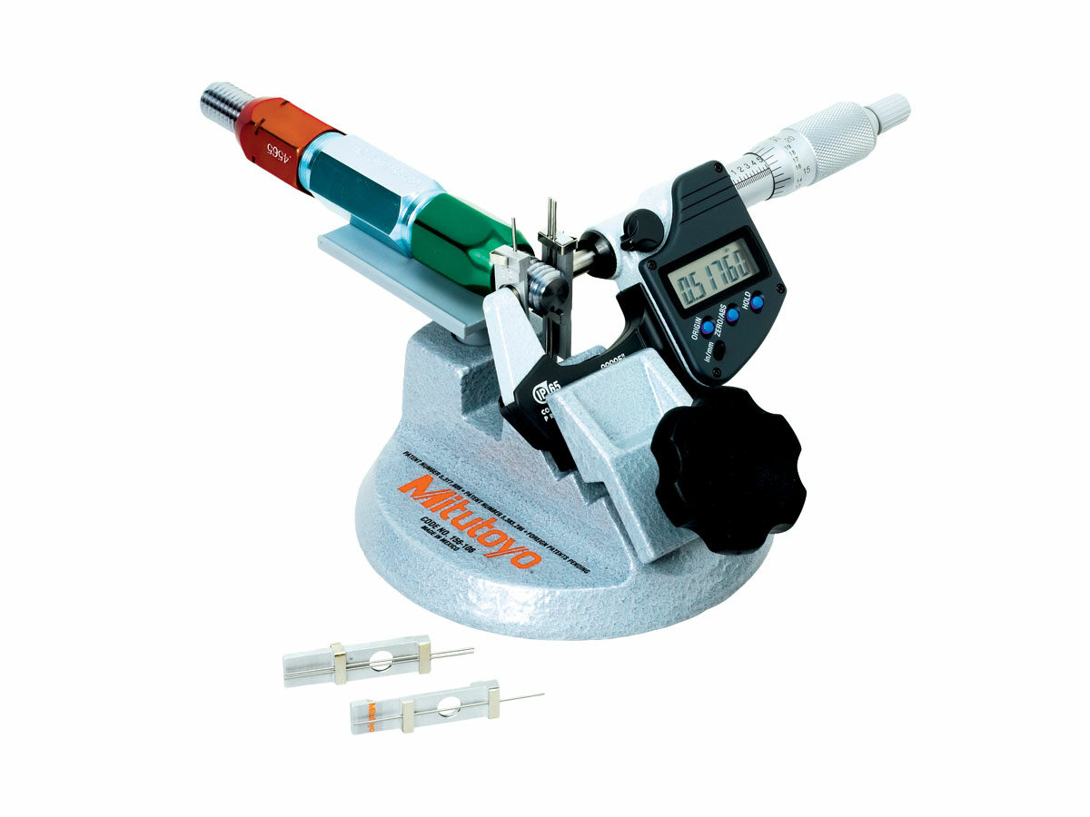

The Mitutoyo 3-wire thread measuring system is a fast and accurate method of attaining a variety of thread measurements with an outside micrometer.
The Mitutoyo 3-wire thread measuring system features hardened, precision lapped wires for accurate results and longer wire lifespan. This measuring system reduces measurement time to a fraction of the time normally taken using the traditional three-wire method.
- Available in Metric and Inch holders and wire sets
- Measuring set is placed onto the spindle and anvil of an outside micrometer
- Measuring wires are hardened and precision lapped
- Vertically adjustable platform supports and positions threaded parts, plug gages between anvil of micrometer
- Includes Certificate of Accuracy
- Traceable to NIST
