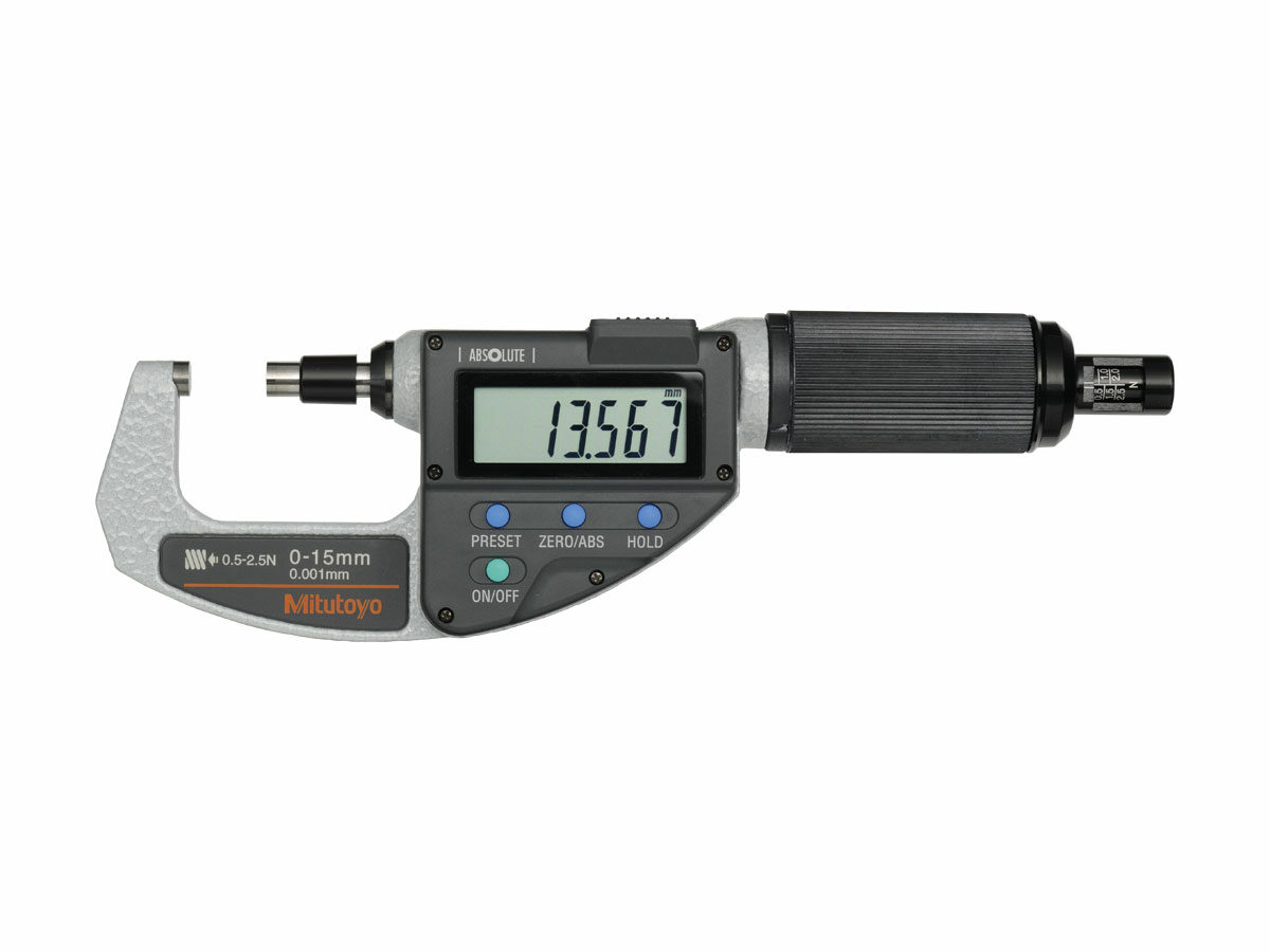

The ABSOLUTE Digimatic micrometer features a constant and low measuring force mechanism in the thimble for measuring applications such as wire, paper, plastic and rubber parts.
The Mitutoyo ABSOLUTE Digimatic micrometer’s adjustable measuring force capabilities accommodates measurements of both soft and hard materials in a variety of applications. The repeatability of the automatically applied measuring force allows operators of all skill levels to perform highly accurate measurements, therefore saving time and money.
- Two different adjustable measuring forces are available: 0.5-2.5N or 2-10N
- The measurement-value hold function automatically retains the data at a specified measuring force, ensuring accuracy
- Non-rotating spindle and the new ratchet friction thimble
- Speedy spindle feed of 10mm/rev. and .4”/rev for inch/metric model
- ABSOLUTE linear scale eliminates the need for setting the origin point every time the micrometer is powered on
- Elimination of overspeed errors provides a higher measurement reliability and repeatability
- Available with SPC data output capabilities
- Functions include Origin Set, Zero/ABS, Hold, Function Lock, Auto Power On/Off, and inch/mm conversion (on inch/metric models only)
- Includes a standard bar to set the origin point (for models with 15-30mm / .6-1.2” range)

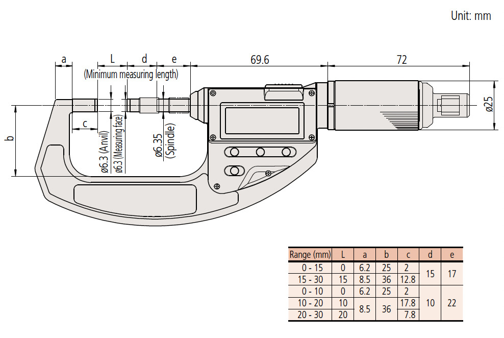

SERIES 227 Technical Data
| Technology: | Digimatic |
| SPC Output: | Yes |
| Ratchet/Thimble: | Ratchet Friction Thimble |
| Measuring Faces: | Carbide tipped |
| Display: | LCD |
| Battery: | SR44 (1pc.) 938882 |
| Battery Life: | Approx. 5 years under normal use |
| Optional Accessories: | 05CZA662, 05CZA663 |
| Order No.: | Product Image: | Units: | Range: | Resolution: | Accuracy: | Mass: | Measuring Force: | Measuring Force Increments: | Flatness: | Parallelism: |
| 227-215-20 | - | Metric, Inch | 0-0.4" / 0-10.16mm | 0.00005" / 0.001mm | ±0.0001" | 340g | 2-10N | 2, 4, 6, 8, 10N | - | 0.00008" or less |
