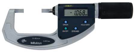

The Mitutoyo digital blade micrometer utilizes a blade anvil and spindle for measuring difficult pieces such as groove diameters of shafts and keyways.
Quickmike Non-Rotating Spindle Blade Micrometer
The Mitutoyo Digimatic non-rotating spindle type blade micrometer quickly measures grooves, keyways and hard-to-reach areas with high accuracy at a faster spindle speed.
The Mitutoyo Quickmike digital blade micrometer utilizes a blade anvil and spindle for measuring difficult pieces such as groove diameters of shafts and keyways. The non-rotating spindle reduces torsion on softer parts being measured and prevents workpiece deformation and wear with a faster spindle feed. A ratchet-stop mechanism provides uniform pressure on a workpiece for precise, repeatable measurements. Measurements are displayed on an easy-to-read LCD readout.
  • The Quickmike blade micrometer provides a speedy spindle feed of 10mm / .4” per thimble rotation compared to the conventional micrometer with 0.5mm / .025” per rotation
  • Ratchet thimble allows for easy single-hand use when measuring objects
  • Elimination of overspeed errors provides higher measurement reliability and repeatability
  • Knurled friction thimbles provide quick adjustments even when wearing gloves
  • IP54 protection resists debris, dust and water

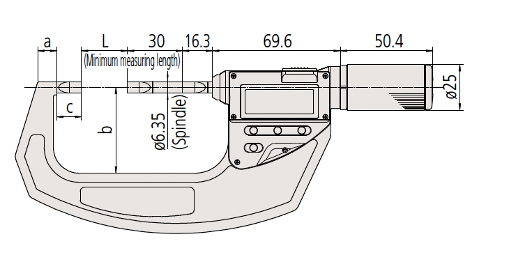

SERIES 422 Technical Data
Technology: Digitmatic
IP Rating: IP65
SPC Output: Yes
Ratchet/Thimble: Ratchet Thimble
Anvil Type: Type A
Battery: SR44 (1 pc.) 938882
Battery Life: Approx. 5 years under normal use
Order No.: Product Image: Units: Range: Resolution: Accuracy: Mass: Parallelism:
422-411 Metric 0-30mm - ±3µm 350g 3µm or less
422-411-20 - Metric 0-30mm 0.001mm ±3µm 350g 3µm or less
422-412 - Metric 25-55mm - ±3µm 490g 3µm or less
422-412-20 - Metric 25-55mm 0.001mm ±3µm 490g 3µm or less
422-421 Metric, Inch 0-1.2" / 0-30.48mm .00005" ±.00015" 350g .00012" or less / 3µm or less
422-421-20 - Metric, Inch 0-1.2" / 0-30.48mm 0.00005" / 0.001mm ±0.00015" / ±3µm 350g 0.00015" or less / 3µm or less
422-422 - Metric, Inch 1-2.2" / 25.4-55.88mm .00005" ±.00015" 490g .00012" or less / 3µm or less
422-422-20 - Metric, Inch 1-2.2" / 25.4-55.88mm 0.00005" / 0.001mm ±0.00015" / ±3µm 490g 0.00015" or less / 3µm or less
