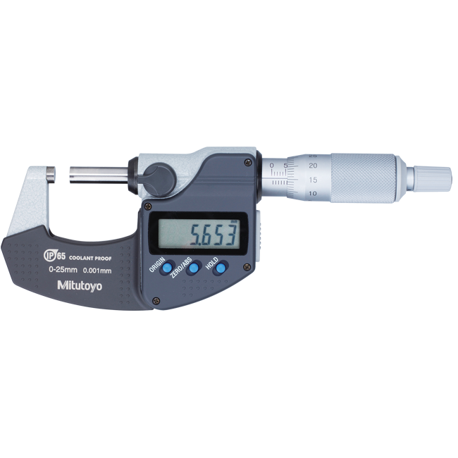

Coolant-Proof Micrometer
The Mitutoyo Digimatic coolant-proof digital SPC output capable micrometer produces highly accurate, repeatable measurements even when exposed to liquids and dirt.
The Mitutoyo IP65 rated coolant-proof micrometer’s ratchet stop thimble mechanism provides a constant measuring force on the spindle to ensure accurate, repeatable measurements. The combination of the ratchet thimble and speeder enables a rapid spindle feed when measuring widely different dimensions, as well as, easier one-handed measurements.
  • Ranges from 0-12”/0-300mm
  • Measurement data output is available with a water-resistant connection cable
  • Frame is coated with an anti-slip finish for improved grip during use
  • Twice as long battery life than previous models improves throughput and efficiency
  • Auto power ON/OFF function saves battery life and allows for easier use
  • Includes a standard bar except for the 0-1”/0-25mm model
  • Some models include a Mitutoyo Certificate of Inspection*
  • Supplied in a plastic, fitted case
*It is not the type used to obtain calibration certificates.
