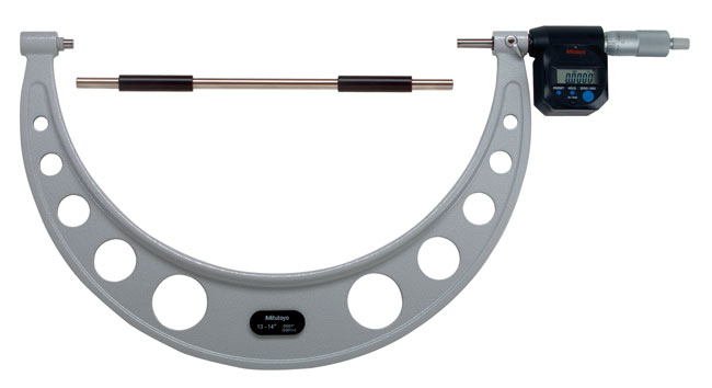

Digimatic Micrometer
The Mitutoyo large span Digimatic micrometer produces highly accurate, repeatable measurements displayed on an easy-to-read LCD readout.
The Mitutoyo Digimatic digital micrometer’s ratchet thimble mechanism provides a constant measuring force on the spindle to ensure accurate, repeatable measurements. The combination of the ratchet thimble and speeder enables a rapid spindle feed when measuring a wide range of different dimensions, or easier one-handed measurements.
  • Ranges from 12-20” / 300-500mm
  • Measurement results are displayed in inches and metric on an LCD readout
  • Carbide-tipped measuring tips resist wear for better accuracy over time
  • Twice as long battery life than previous models improves throughput and efficiency
  • Auto power ON/OFF function saves battery life makes for easier use
  • Functions include preset, zero-setting, power ON/OFF, data hold, data output and inch/mm conversions (inch/mm models only)
SERIES 293 Technical Data
Technology: Digimatic
SPC Output: Yes
Ratchet/Thimble: Ratchet Stop
Measuring Force: 10-14N
Measuring Faces: Carbide tip
Battery: SR44 (2pcs.) 938882
Battery Life: Approx. 1.8 years under normal use
Optional Accessories: 04AZB512, 04AZB513, 959149, 959150
