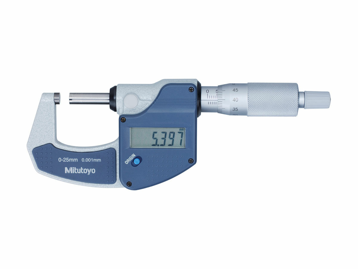

Digimatic Micrometer – MDC Lite
The MDC-Lite Digimatic micrometer provides highly accurate outside measurements in a simple, efficient design.
The Mitutoyo MDC-Lite Digimatic digital micrometer’s ratchet thimble mechanism provides a constant measuring force on the spindle to ensure accurate, repeatable measurements. The combination of the ratchet thimble and speeder enables a rapid spindle feed when measuring a wide range of different dimensions, or easier one-handed measurements.
  • The MDC-Lite has no spindle clamp or data output function
  • Provided only with a zero-set key and in/mm (inch/metric models only)
  • Measurement results are displayed in inches and metric on an LCD display
  • Carbide-tipped measuring tips resist wear for better accuracy over time
  • Twice as long battery life than previous models improves throughput and efficiency
  • Unit turns off after 20 minutes of idle time; conveniently turns on with twist of the spindle
  • Supplied in a plastic, fitted case
Technology: Digimatic
SPC Output: No
Mass: 270g
Measuring Force: 5-10N
Battery: SR44 (1pc.) 938882
Order No.: Product Image: Units: Range: Resolution: Accuracy: Ratchet/Thimble: Flatness: Parallelism:

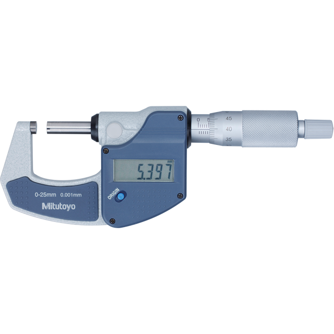

293-821-30 Metric 0-25mm 0.001mm ±2µm Ratchet Stop 0.3µm 2µm or less

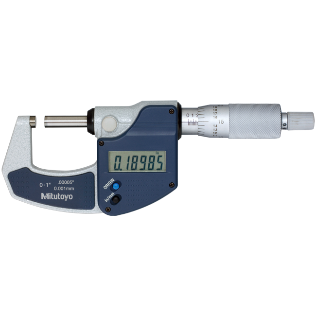

293-831-30 Metric, Inch 0-1" / 0-25.4mm 0.00005" / 0.001mm ±.0001" Ratchet Stop 0.3µm 0.00008" or less / 2µm or less
293-832-30 Metric, Inch 0-1" / 0-25.4mm 0.00005" / 0.001mm ±.0001" Friction Thimble 0.3µm 0.00008" or less / 2µm or less
