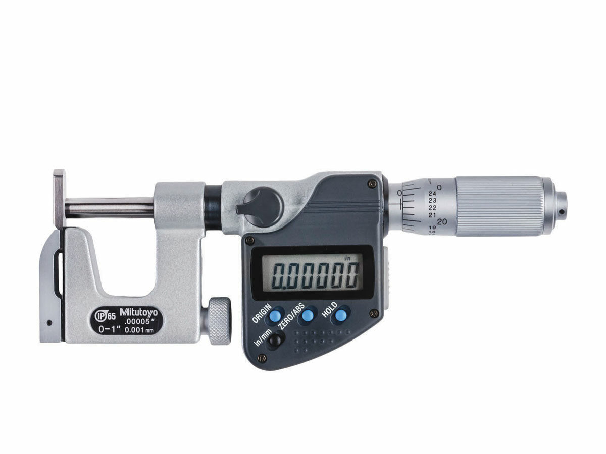

The digimatic Uni-Mike with a clamp to allow for different types of anivls
Digimatic “Uni-Mike”- Friction Thimble

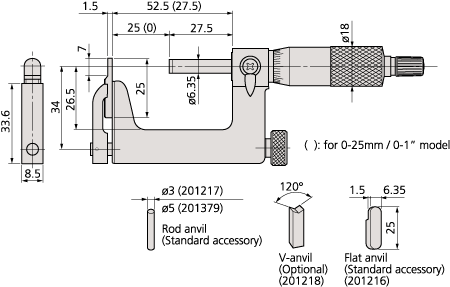

The Mitutoyo Digimatic Uni-Mike provides great versatility to acquire highly accurate measurements on different types of workpieces. This micrometer has an IP65 dust and water protection level.
The Mitutoyo Uni-Mike digital micrometer features a clamp on the anvil side of the micrometer’s frame to allow the use of several different types of anvils. Depending on the type of anvil used, the Uni-Mike is proficient at measuring the thickness of tubes, rivet head heights, and shoulder-edge distances.
  • Metric models include a ratchet stop thimble with a constant measuring force
  • Standard flat anvil
  • Standard rod anvil
  • Optional V-anvil
  • Carbide tips resists wear on the measuring faces for accurate measurements for an extended period of time
  • Certificate of Inspection is provided
  • Includes a standard bar except for 0-25 mm and 0-1” models
