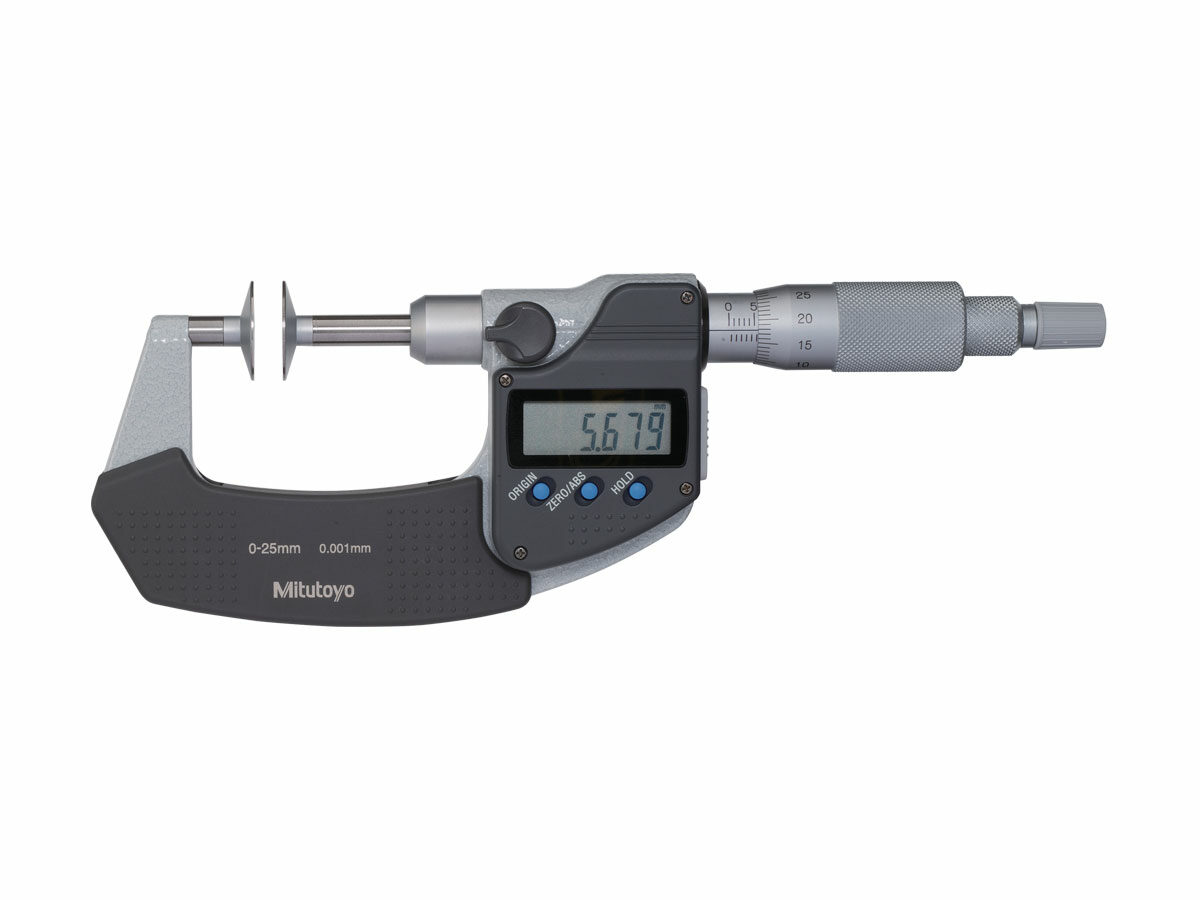

The Mitutoyo Digimatic non-rotating spindle disc micrometer is designed to measure the root tangent length of spur gears and helical gears with high accuracy.
The Mitutoyo digital disc micrometer uses flat discs and non-rotating spindle made with hardened steel in our own Japanese factory to measure lengths of spur and helical gears. The flatness and thinness of the discs allow for reliable measurements in tight spaces. The non-rotating spindle reduces torque on parts being measured and prevents workpiece deformation and wear. A ratchet-stop mechanism provides uniform pressure on a workpiece for precise, repeatable measurements. Readings are displayed on an easy-to-read LCD readout.
- Diameter of measuring discs is 20mm / .787”
- Measuring surfaces are constructed of carbide to reduce wear
- Ratchet mechanism provides an audible click to ensure measurement is performed at a constant force
- SPC output function allows for quick and easy data management in real time
- Functions include Origin Set, Zero/ABS Setting, Data Hold, Data Output, Function Lock, and inch/mm conversion (on inch/metric models only)
- Frame has a non-slip finish for better grip in shop environments
- Includes a standard bar except for 0-15mm / 0-.6”, 0-25mm / 0-1”, and 0-30mm / 0-1.2” models

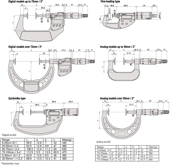

SERIES 369 Technical Data
| Technology: | Digimatic |
| SPC Output: | Yes |
| Ratchet/Thimble: | Ratchet Stop |
| Measuring Force: | 3-8N |
| Display: | LCD |
| Battery Life: | Approx. 2.4 years under normal use |
| Optional Accessories: | 05CZA662, 05CZA663 |
