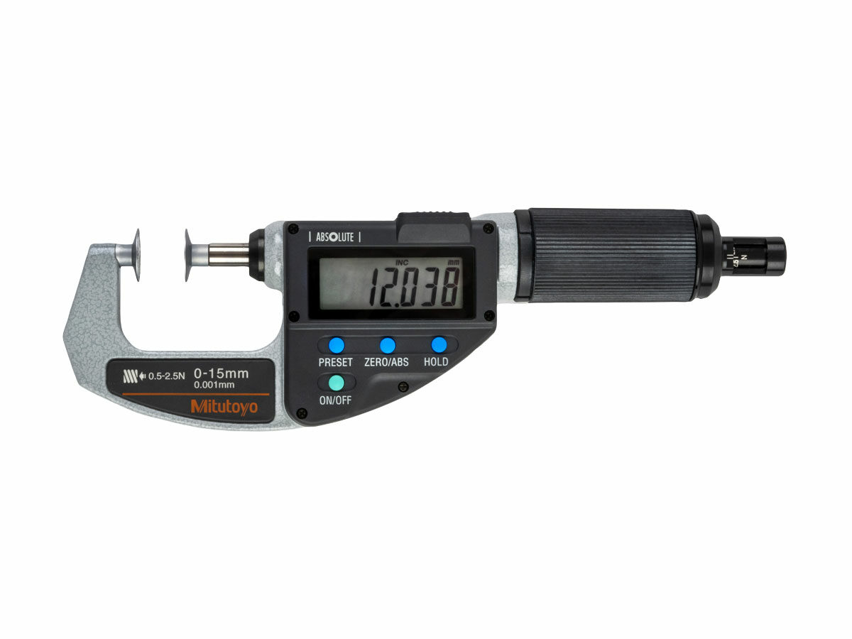

The Mitutoyo ABSOLUTE Digimatic Quickmike-type digital disc micrometer measures the root tangent length of spur gears and helical gears with high accuracy and faster speeds.
The Mitutoyo ABSOLUTE Quickmike disc micrometer uses flat discs constructed of hardened steel, in our own Japanese factory, to measure lengths of spur and helical gears. The non-rotating spindle prevents workpiece deformation and wear by reducing torque on parts being measured. The flatness and thinness of the discs allow for reliable measurements in tight spaces. A ratchet-stop mechanism provides uniform pressure on a workpiece for precise, repeatable measurements and eliminates over-speed error.
- Quickmike type disc micrometer has a 20 times faster feed rate and spindle speed at 10mm/revolution
- ABSOLUTE linear scale eliminates the need for setting the origin point every time the micrometer is powered on
- Elimination of overspeed errors provides higher measurement reliability and repeatability
- SPC output function allows for quick and easy data management in real time
- Functions include Origin Set, Zero/ABS Setting, Data Hold, Data Output, Function Lock, and inch/mm conversion (on inch/metric models only)
- Ratchet mechanism provides an audible lick to ensure measurement is performed at a constant force
- Frame has a non-slip finish for better grip in shop environments
