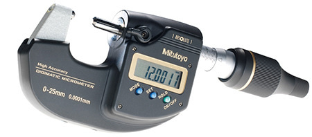

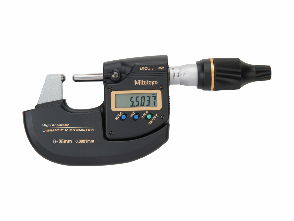

The MDH Digimatic ABSOLUTE micrometer is the world’s first 0.1µm resolution micrometer
The Mitutoyo MDH Digimatic ABSOLUTE digital micrometer provides fast and easy high-accuracy measurements on workpieces that require absolute precision. Exceptional performance is achieved due to the MDH’s highly rigid frame, high performing constant-force ratchet mechanism and innovative thread cutting technology in the spindle.
  • Enabling .000005” / 0.1μm resolution measurement, this micrometer is ideal for customers who need to make highly accurate measurements with a hand-held tool
  • A highly rigid frame and high-performance constant-force mechanism* enable more stable measurements , while the clicks emitted when the work piece is being measured assure the operator that measurement is proceeding normally
  • Body heat transferred to the instrument is reduced by a (removable) heat shield, minimizing the error caused by thermal expansion of the frame when performing handheld measurements
  • The ABS (absolute) rotary sensor also eliminates the need to perform origin setting every time the power is turned on, offering immediate measurement
  • With no possibility of over speed errors, the High-Accuracy Digimatic Micrometer also delivers a high level of reliability
  • Carbide tips help resist wear on the measuring faces for accurate measurements over an extended period of time
  • Built-in “Hold” function freezes the displayed value, enabling the micrometer to be removed from a workpiece for better viewing when the readout is not easily visible
  • Functions include Preset, Zero-Setting (INC measurement system), Hold, Resolution Switching, Function Lock, ON/OFF, Auto Power Off, Measurement Data Output, Error Alarm

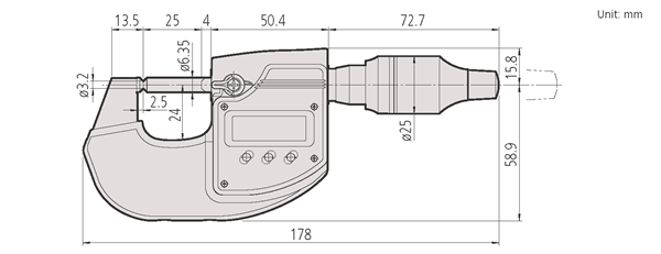

SERIES 293 Technical Data
Technology: Digimatic
SPC Output: Yes
Ratchet/Thimble: Ratchet Thimble
Mass: 400g
Measuring Force: 7-9N
Battery: Lithium battery CR2032 (1 pc.)
Battery Life: Approx. 2 years under normal use
Order No.: Product Image: Units: Range: Resolution: Accuracy: Flatness: Parallelism:
293-100-10 Metric 0-25mm 0.0001, 0.0005mm ±0.5µm 0.3µm 0.6µm or less
293-130-10 Metric, Inch 0-1" / 0-25.4mm 0.000005, 0.00002" / 0.0001, 0.0005mm ±.00002" 0.3µm 0.000024" or less / 0.6µm or less
