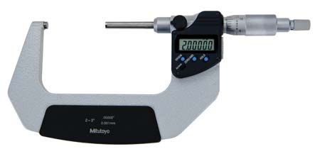

The non-rotating spindle type Digimatic outside micrometer provides steady positioning during measurement for better accuracy repeatability.

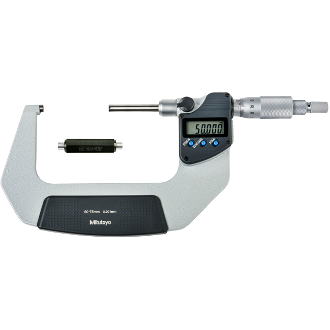

The Mitutoyo Digimatic digital micrometer with non-rotating spindle reduces torsion on softer parts being measured and prevents workpiece deformation and wear. A ratchet-stop mechanism provides uniform pressure on a workpiece for precise, repeatable measurements. Measurements are displayed on a coolant-proof, easy-to-read LCD readout.
  • Available in metric and inch/metric models
  • Ratchet thimble allows for easy single-hand use when measuring objects
  • ABSOLUTE linear scale eliminates the need for setting the origin point every time the micrometer is powered on
  • Elimination of overspeed errors provides for more reliable and repeatable measurement
  • Functions include Origin Set, Zero/ABS, Hold, Function Lock, Data Output, and inch/mm conversion (on inch/metric models only)

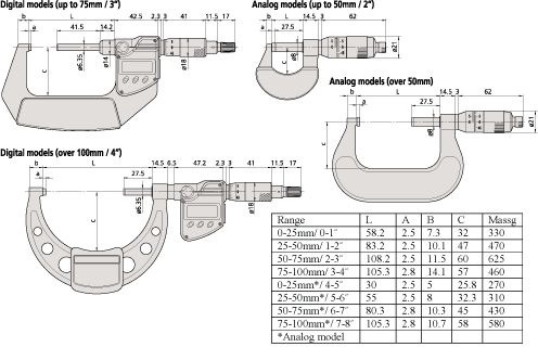

Order No.: Product Image: Units: Range: Resolution: Accuracy: Flatness: Parallelism:
406-250-30 Metric 0-25mm 0.001mm ±3µm 0.3µm 3µm or less
406-251-30 - Metric 25-50mm 0.001mm ±3µm 0.3µm 3µm or less
406-252-30 Metric 50-75mm 0.001mm ±3µm 0.3µm 3µm or less
406-253-30 - Metric 75-100mm 0.001mm ±4µm 0.3µm 4µm or less

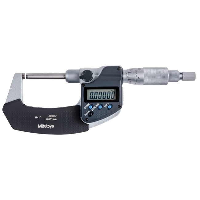

406-350-30 Metric, Inch 0-1" / 0-25.4mm 0.00005" / 0.001mm ±.00015" 0.3µm 0.00012" or less / 3µm or less
406-351-30 - Metric, Inch 1-2" / 25.4-50.8mm 0.00005" / 0.001mm ±.00015" 0.3µm 0.00012" or less / 3µm or less
406-352-30 Metric, Inch 2-3" / 50.8-72.6mm 0.00005" / 0.001mm ±.00015" 0.3µm 0.00012" or less / 3µm or less
406-353-30 - Metric, Inch 3-4" / 76.2-101.6mm 0.00005" / 0.001mm ±.0002" 0.3µm 0.00016" or less / 4µm or less
