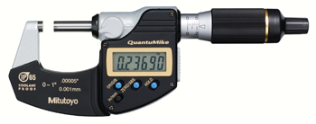

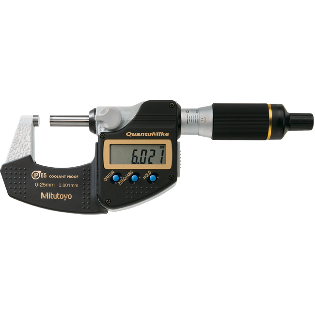

The QuantuMike Digimatic coolant-proof digital micrometer delivers quick, high accurate measurements with a reduction in positioning time. This QuantuMike model is SPC output capable.
The Mitutoyo digital QuantuMike utilizes a courser spindle thread which feeds the spindle by 2mm per revolution of the thimble instead of the standard 0.5mm. The coolant-proof micrometer’s ratchet thimble mechanism provides a constant measuring force on the spindle to ensure accurate, repeatable measurements.
- A highly rigid frame and high-performance constant-force mechanism* enable more stable measurements, while the clicks emitted when the work piece is being measured assure the operator that measurement is proceeding normally
- Carbide tips resists wear on the measuring faces for accurate measurements for an extended period of time
- Built-in “Hold” function freezes the displayed value, enabling the micrometer to be removed from a workpiece for better viewing when the readout is not easily visible
- Functions include Origin Set, Zero/ABS, Hold, Function Lock, Auto Power On/Off, and inch/mm conversion (on inch/metric models only)
- Models are also available without SPC output
- Certificate of Inspection is provided
- IP65 protection permits use in environments exposed to cutting oil, dust, etc.**

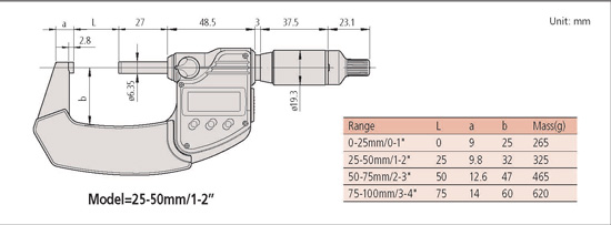

SERIES 293 Technical Data
| Technology: | Digimatic |
| IP Rating: | IP65 |
| Ratchet/Thimble: | Ratchet Thimble |
| Measuring Force: | 7-12N |
| Measuring Faces: | Carbide tipped |
| Display: | LCD |
| Battery Life: | Approx. 2.4 years under normal use |
