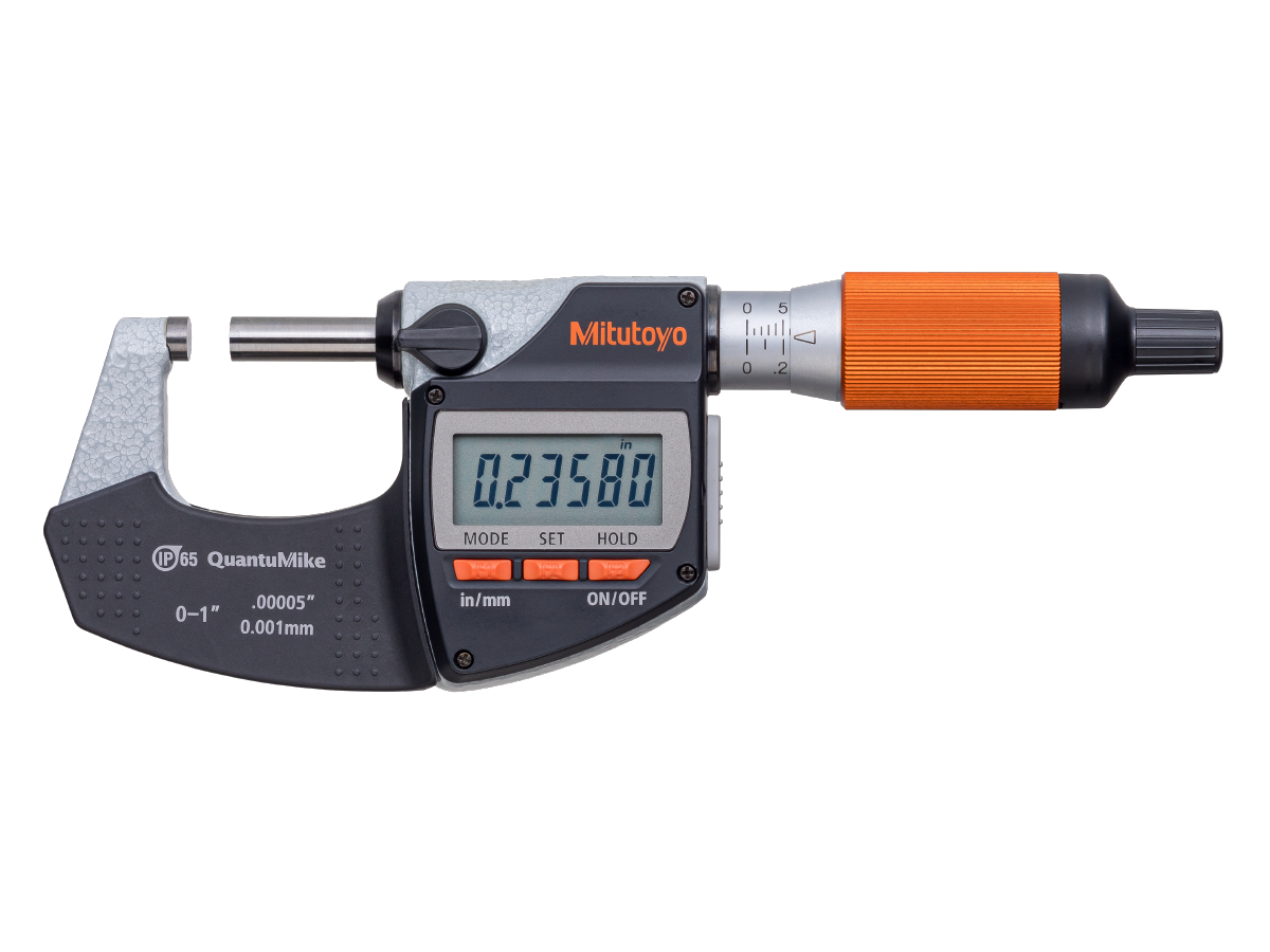

NEW MDE QuantuMike
The MDE Quantumike Micrometer offers rapid and precise measurements with its unique wider thread pitch, moving the spindle 2.0 mm per rotation — up to 4x faster than standard micrometers. It features exceptional accuracy with a ±1 μm permissible error, an IP65 protection rating, and a user-friendly design with enhanced display and customizable settings, making it ideal for demanding, high-precision applications.
  • Rapid Measurement with High-Speed Movement
    • Utilizing a unique processing technology, the MDE Quantumike features a wider thread pitch, enabling the spindle to move 2.0 mm per rotation—four times faster than typical micrometers. This allows for quick and efficient measurements, making it ideal for tasks requiring multiple dimension checks.
  • Exceptional Accuracy
    • The MDE Quantumike boasts a maximum permissible error of just ±1 μm, ensuring it meets the demands of high-precision workpieces.
  • Durable and Reliable
    • With an IP65 protection rating, this micrometer is water-resistant and dust-resistant, capable of withstanding challenging environments where exposure to coolant and debris is common.
  • Enhanced Usability
    • The ratchet thimble mechanism ensures stable, one-handed operation, providing tactile feedback through ratcheting sounds to confirm secure measurements. The speeder ratchet aids in rapid spindle feed, improving efficiency.
  • Operation and Calibration Features
    • An approach speed warning function helps prevent damage from excessive speed, with a flashing display to alert users. Calibration management is simplified with warning alerts for upcoming calibration dates, ensuring your device remains accurate and reliable.
  • Improved Display and Interface
    • The display is larger and easier to read from any angle, featuring clear measurement values and icons. Larger buttons enhance usability, and key operations can be customized for a more intuitive user experience.
  • Bidirectional Digimatic S1 Communication
    • Seamlessly manage and configure your Digimatic gages with bidirectional serial communication. This feature allows for easy setup and monitoring of Digimatic gages directly from your PC, enabling precise and efficient management. Apply consistent settings across multiple gages simultaneously, saving time and ensuring uniformity across your operations.
  • User-Friendly Design
    • Tolerance (GO/NG) icons on the LCD display for quick judgments
