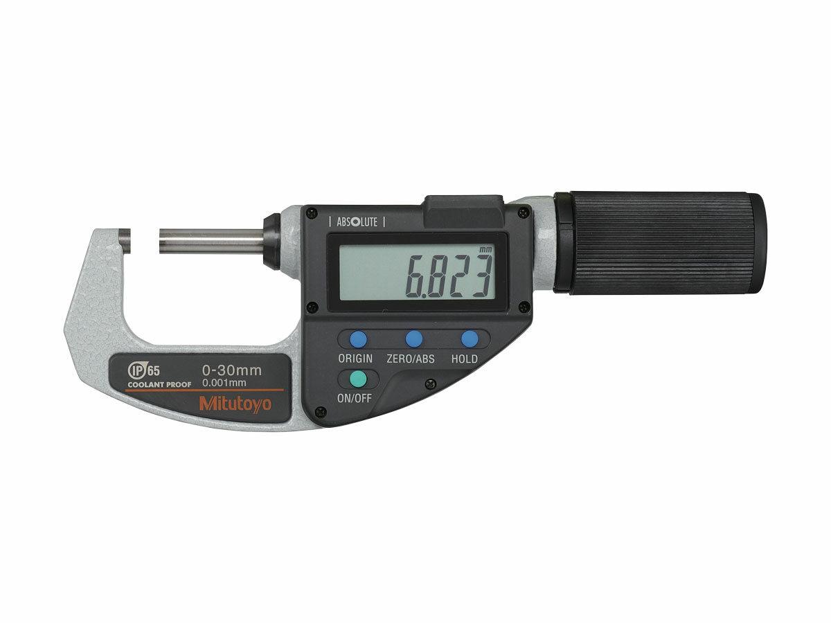

Mitutoyo Quickmike made for fast measurements in metrology
Quickmike
The Quickmike digital micrometer has a fast spindle feed which allows various shapes to be measured quickly.
The Mitutoyo Digimatic Quickmike coolant proof digital micrometer feeds the spindle 10mm per thimble rotation, or 20-times faster than standard micrometers. This speed provides quicker measurements on different sized features. Its wide 30mm / 1.2” measuring range allows for measuring of different workpieces without sacrificing speed or accuracy.
  • The Quickmike provides a speedy spindle feed of 10mm / .4” per thimble rotation compared to the conventional micrometer with 5mm / .025” per rotation.
  • Non-rotating spindle and the new ratchet friction thimble reduces torsion on softer parts being measured
  • Ratchet thimble allows for easy single-hand use when measuring objects
  • ABSOLUTE linear scale eliminates the need for setting the origin point every time the micrometer is powered on
  • Elimination of overspeed errors provides a higher measurement reliability and repeatability
  • IP54 protection permits use in environments exposed to cutting oil, coolant, dust, etc., for use on most shop floor environments
  • Available with SPC data output capabilities
  • Includes a standard bar to set the origin point (for models with 25-55mm / 1-2.2” ranges or larger)

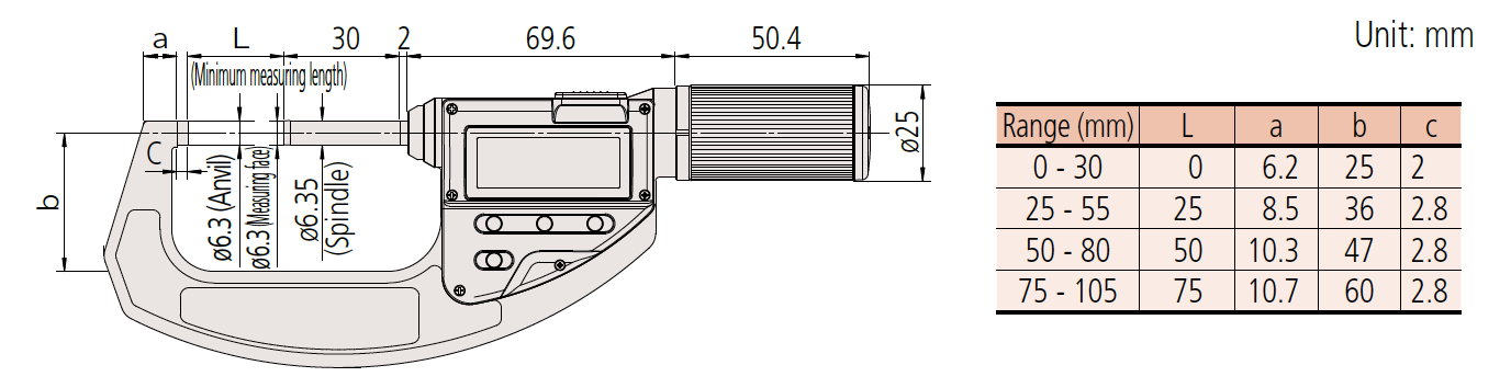

SERIES 293 Technical Data
Technology: Digimatic
IP Rating: IP65
SPC Output: Yes
Ratchet/Thimble: Ratchet Friction Thimble
Measuring Force: 5-12N
Battery: SR44 (1pc.) 938882
Battery Life: Approx. 5 years under normal use
Order No.: Product Image: Units: Range: Resolution: Accuracy: Mass: Flatness: Parallelism:
293-668-20 Metric 50-80mm 0.001mm ±3µm 525g 0.3µm 2µm or less
293-669-20 Metric 75-105mm 0.001mm ±3µm 625g 0.3µm 3µm or less
293-676-20 Metric, Inch 0-1.2" / 0-30.48mm 0.00005" / 0.001mm - 275g 0.3µm 0.00008" or less / 2µm or less
293-677-20 Metric, Inch 1-2.2" / 25.4-55.88mm 0.00005" / 0.001mm - 355g 0.3µm 0.00008" or less / 2µm or less
293-678-20 Metric, Inch 2-3.2" / 50.8-81.28mm 0.00005" / 0.001mm - 525g 0.3µm 0.00008" or less / 2µm or less
293-679-20 Metric, Inch 3-4.2" / 76.2-106.68mm 0.00005" / 0.001mm - 625g 0.3µm 0.00012" or less / 3µm or less
