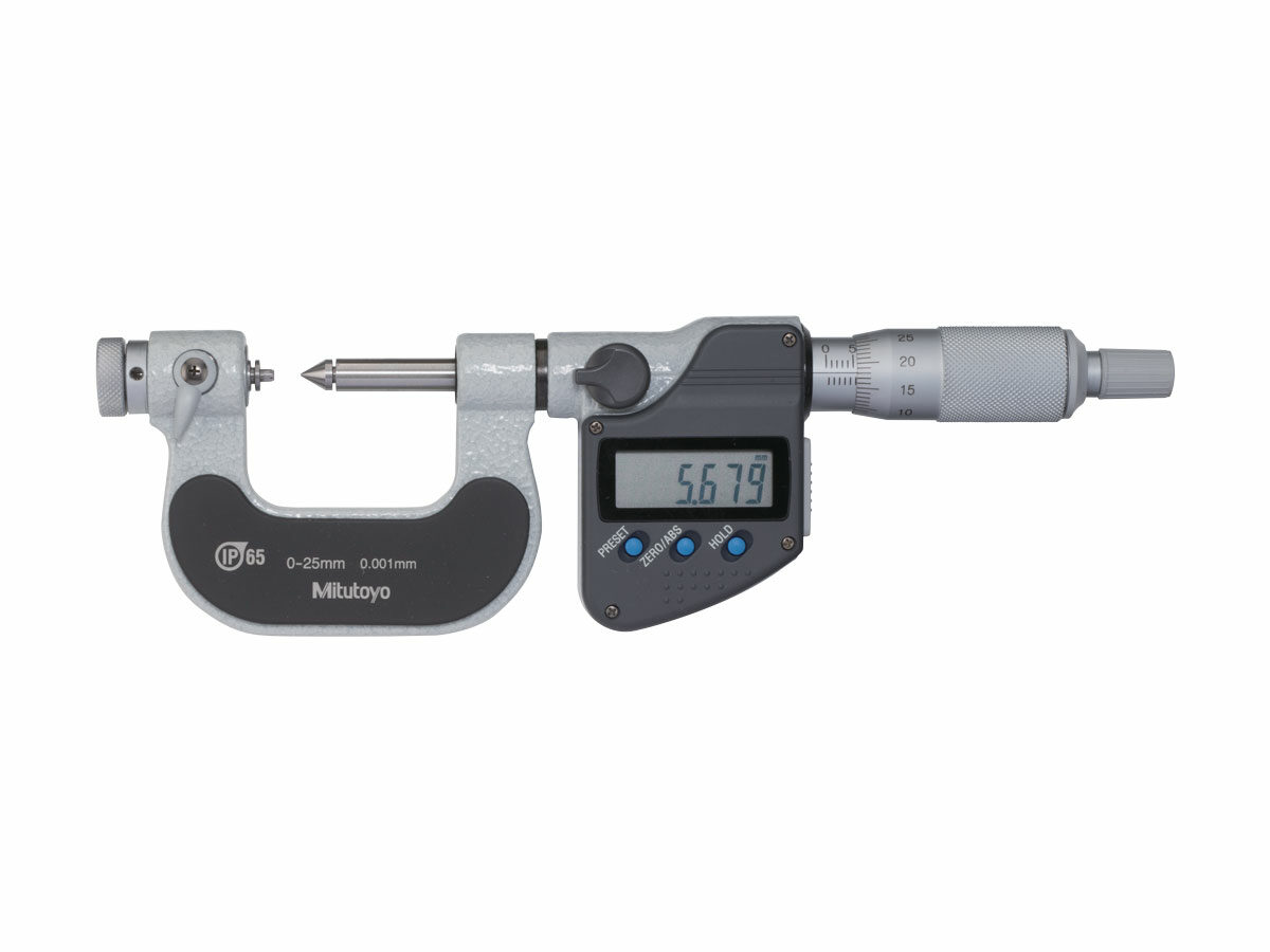

Screw Thread Micrometer-Interchangeable
The Mitutoyo Digimatic screw thread digital micrometer uses interchangeable anvils and spindle tips to perform accurate measurement of different types of screw thread pitch diameters quicker and easier.
The digital Mitutoyo screw thread micrometer with interchangeable anvil and spindle tips uses optional V-anvil and conical spindle inserts interchangeably to precisely measure pitch diameters of metric or unified screw threads. A ratchet-stop mechanism provides uniform pressure on a workpiece for precise, repeatable measurements. Readings are displayed on an easy-to-read LCD readout.
  • Optional interchangeable 60-degree and 55-degree V-anvil  and conical spindle inserts are precision hardened, high-grade steel
  • Functions include Zero/ABS Setting, Data Hold, Data Output, Function Lock, 2 Presets, and inch/mm conversion (on inch/metric models only)
  • Satin chrome finish on the sleeve and laser etched scale on thimble for easier reading
  • Includes a standard bar except for 0-25mm and 0-1” models
Technology: Digimatic
IP Rating: IP65
SPC Output: Yes
Ratchet/Thimble: Ratchet Stop
Battery: SR44 (1 pc.) 938882
Optional Accessories: 05CZA662, 05CZA663, 126-800, 126-810

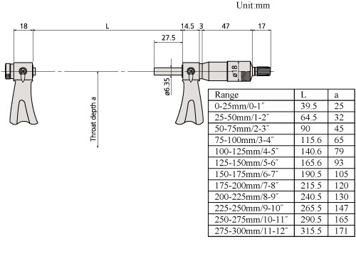

Order No.: Product Image: Units: Range: Resolution: Spindle Feed Error: Mass: Graduation:
326-251-30 - Metric 0-25mm 0.001mm 3µm 350g 0.01mm
326-252-30 - Metric 25-50mm 0.001mm 3µm 380g 0.01mm
326-253-30 - Metric 50-75mm 0.001mm 3µm 470g 0.01mm
326-254-30 - Metric 75-100mm 0.001mm 3µm 510g 0.01mm
326-351-30 Metric, Inch 0-1" / 0-25mm 0.00005" / 0.001mm 0.00015" / 3µm 350g 0.001" / 0.01mm
326-352-30 - Metric, Inch 1-2" / 25-50mm 0.00005" / 0.001mm 0.00015" / 3µm 380g 0.001" / 0.01mm
326-353-30 - Metric, Inch 2-3" / 50-75mm 0.00005" / 0.001mm 0.00015" / 3µm 470g 0.001" / 0.01mm
326-354-30 - Metric, Inch 3-4" / 75-100mm 0.00005" / 0.001mm 0.00015" / 3µm 510g 0.001" / 0.01mm
