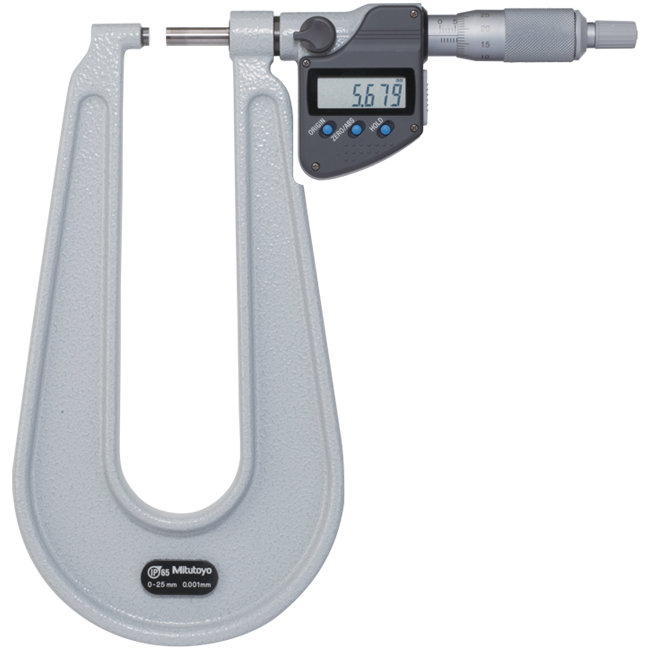

Sheet Metal Micrometer
The Mitutoyo Digimatic sheet metal micrometer is designed with a deep measuring throat to enable multiple measurements across a linear plane on materials such as sheet metal, paper, plastic and rubber. This micrometer has an IP65 dust and water protection level.
The Mitutoyo digital sheet metal micrometer is available with a 6-inch or 12-inch throat, allowing the user to take measurements in the middle of sheets of metal, plastic, rubber and paper with high accuracy. Readings are displayed on an easy-to-read LCD readout with accessible function buttons. The coolant-proof micrometer’s ratchet thimble mechanism provides a constant measuring force on the spindle to ensure accurate, repeatable measurements.
  • Models with a spherical anvil and flat spindle, and spherical anvil and spherical spindle are available
  • Available in Metric or Inch/Metric models
  • Carbide tips help resist wear on the measuring faces for accurate measurements for an extended period of time
  • Satin chrome finish on the sleeve and laser etched scale on thimble for easier reading
  • Certificate of Inspection is provided
  • Includes a standard bar except for 0-1” / 0-25mm model
