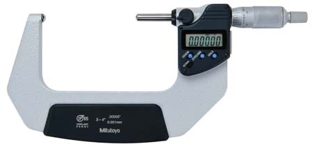

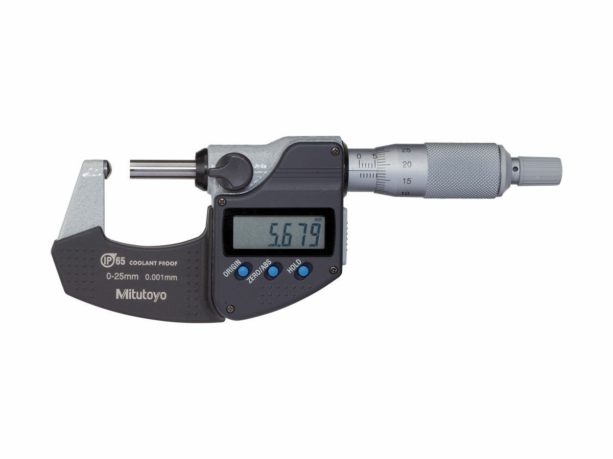

The Mitutoyo digimatic coolant-proof spherical face micrometer measures the wall thickness of various tubing within +/- 0.0001” of accuracy. This micrometer has an IP65 dust and water protection level.
The Mitutoyo digimatic digital spherical micrometer is available with either a spherical face on the anvil and a flat spindle measuring surface or with spherical measuring surfaces on the anvil and spindle. A ratchet-stop mechanism provides uniform pressure on a workpiece for precise, repeatable measurements and eliminates over-speed error. The micrometer has a measurement range of 0 to 1.0″ (0 to 25.4mm), resolution of 0.00005″ (0.001mm), and an accuracy of +/- 0.0001″
  • Available with spherical anvil and flat spindle or with spherical anvil and spherical spindle
  • Designed to measure the wall thickness of various tubing, curved parts and pipe wall thickness
  • Spherical measuring faces are 0.59” in diameter and carbide-tipped for durability
  • IP65 protection permits use in environments exposed to cutting oil, coolant, dust, etc., for most shop floor environments
  • Ratchet mechanism provides an audible click to ensure measurement is being performed at a constant force
  • Includes a standard bar except for 0-1” and 0-25mm models
