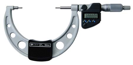

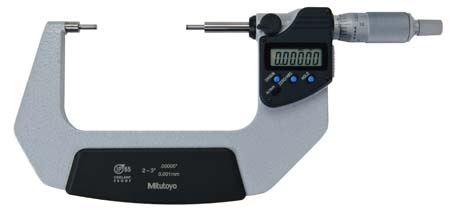

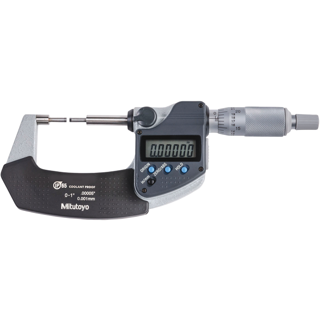

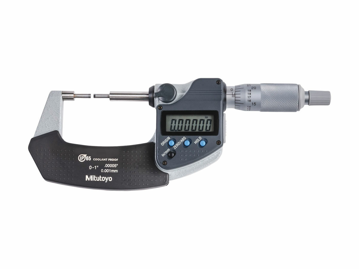

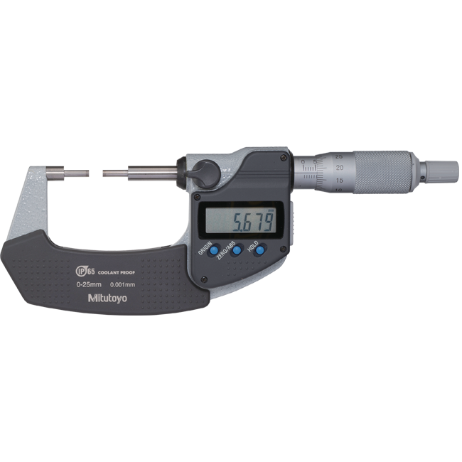

The Mitutoyo Digimatic coolant-proof digital spline micrometer features a reduced diameter anvil and spindle for measuring splined shafts, slots and keyways. This micrometer has an IP65 dust and water protection level.
The digital Mitutoyo spline micrometer is ideal for measuring minor indents, slots, spline shafts and keyways on workpieces. The anvil and spindle each have reduced diameters to better measure internal features with high accuracy. A ratchet-stop mechanism provides uniform pressure on a workpiece for precise, repeatable measurements. Measurements are displayed on a coolant-proof, easy-to-read LCD display.
  • Available in Metric and Inch/Metric Models
  • IP65 protection permits use in environments exposed to cutting oil, coolant, dust, etc., for use on most shop floor environments
  • Functions include Origin Set, Zero Setting, Data Hold, Function Lock, Data Output, and inch/mm conversion (on inch/metric models only)
  • Scale is laser etched on thimble for easier reading
  • Includes a standard bar except for 0-25mm models

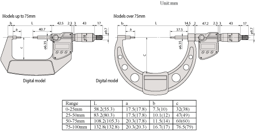

331-251-30 Metric 0-25mm 0.001mm ±2µm 330g 0.01mm 0.3µm 2µm or less Type A
331-252-30 - Metric 25-50mm 0.001mm ±2µm 470g 0.01mm 0.3µm 2µm or less Type A
331-253-30 - Metric 50-75mm 0.001mm ±2µm 625g 0.01mm 0.3µm 2µm or less Type A
331-254-30 - Metric 75-100mm 0.001mm ±3µm 565g 0.01mm 0.3µm 3µm or less Type A
331-261-30 - Metric 0-25mm 0.001mm ±2µm 330g 0.01mm 0.3µm 2µm or less Type B
331-262-30 - Metric 25-50mm 0.001mm ±2µm 470g 0.01mm 0.3µm 2µm or less Type B
331-263-30 - Metric 50-75mm 0.001mm ±2µm 625g 0.01mm 0.3µm 2µm or less Type B
331-264-30 - Metric 75-100mm 0.001mm ±3µm 565g 0.01mm 0.3µm 3µm or less Type B
331-351-30 Metric, Inch 0-1" / 0-25.4mm 0.00005" / 0.001mm ±.0001" / ±2µm 330g 0.01mm / 0.0001" 0.3µm 0.00008" or less / 2µm or less Type A
331-352-30 - Metric, Inch 1-2" / 25.4-50.8mm 0.00005" / 0.001mm ±.0001" / ±2µm 470g 0.01mm / 0.0001" 0.3µm 0.00008" or less / 2µm or less Type A
331-353-30 Metric, Inch 2-3" / 50.8-76.2mm 0.00005" / 0.001mm ±.0001" / ±2µm 625g 0.01mm / 0.0001" 0.3µm 0.00008" or less / 2µm or less Type A
331-354-30 Metric, Inch 3-4" / 76.2-101.6mm 0.00005" / 0.001mm ±.00015" / ±3µm 565g 0.01mm / 0.0001" 0.3µm 0.00012" or less / 3µm or less Type A
331-361-30 - Metric, Inch 0-1" / 0-25.4mm 0.00005" / 0.001mm ±.0001" / ±2µm 330g 0.01mm / 0.0001" 0.3µm 0.00008" or less / 2µm or less Type B
331-362-30 - Metric, Inch 1-2" / 25.4-50.8mm 0.00005" / 0.001mm ±.0001" / ±2µm 470g 0.01mm / 0.0001" 0.3µm 0.00008" or less / 2µm or less Type B
331-363-30 - Metric, Inch 2-3" / 50.8-76.2mm 0.00005" / 0.001mm ±.0001" / ±2µm 625g 0.01mm / 0.0001" 0.3µm 0.00008" or less / 2µm or less Type B
331-364-30 - Metric, Inch 3-4" / 76.2-101.6mm 0.00005" / 0.001mm ±.00015" / ±3µm 565g 0.01mm / 0.0001" 0.3µm 0.00012" or less / 3µm or less Type B
