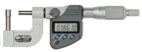

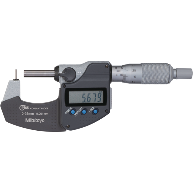

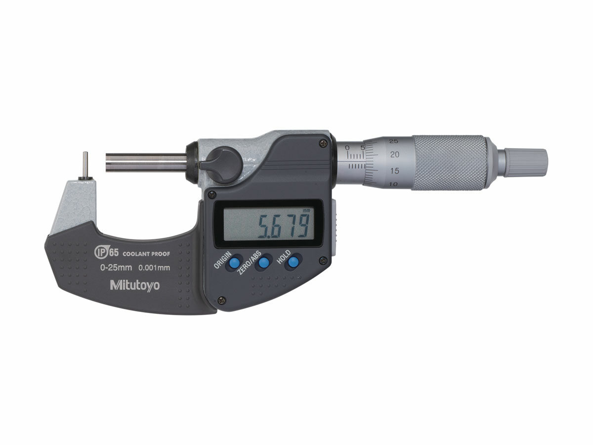

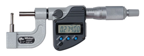

The Mitutoyo Digimatic coolant-proof tube micrometer measures the thickness of tube walls within +/- 0.00015” of accuracy. This micrometer has an IP65 dust and water protection level.
The Mitutoyo Digimatic digital tube micrometer is available with either flat or spherical measuring face options to measure the wall thickness of various tubes. A ratchet-stop mechanism provides uniform pressure on a workpiece for precise, repeatable measurements and eliminates over-speed error.

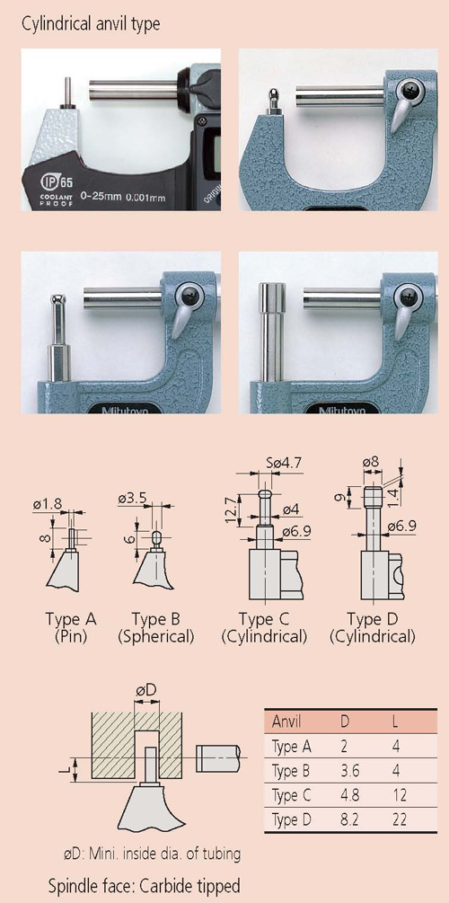

  • Available with pin, spherical and cylindrical anvils
  • Designed to measure the wall thickness of various tubing
  • Measuring surfaces are constructed of carbide to reduce wear
  • IP65 protection permits use in environments exposed to cutting oil, coolant, dust, etc., for most shop floor environments
  • Ratchet mechanism provides an audible click to ensure measurement is being performed at a constant force
  • Includes a standard bar except for 0-25mm and 0-1” model

Order No.: Product Image: Units: Range: Resolution: Accuracy: Mass: Graduation: Flatness: Remarks:
395-261-30 Metric 0-25mm 0.001mm ±3µm 270g 0.01mm 0.3µm Type A
395-262-30 - Metric 0-25mm 0.001mm ±3µm 270g 0.01mm 0.3µm Type B
395-263-30 - Metric 0-25mm 0.001mm ±3µm 310g 0.01mm 0.3µm Type C
395-264-30 - Metric 0-25mm 0.001mm ±3µm 310g 0.01mm 0.3µm Type D
395-362-30 - Metric, Inch 0-1" / 0-25.4mm 0.00005" / 0.001mm ±.00015" / ±3µm 270g 0.0010" / 0.01mm 0.3µm Type B
395-363-30 Metric, Inch 0-1" / 0-25.4mm 0.00005" / 0.001mm ±.00015" / ±3µm 310g 0.0010" / 0.01mm 0.3µm Type C
395-364-30 Metric, Inch 0-1" / 0-25.4mm 0.00005" / 0.001mm ±.00015" / ±3µm 310g 0.0010" / 0.01mm 0.3µm Type D
