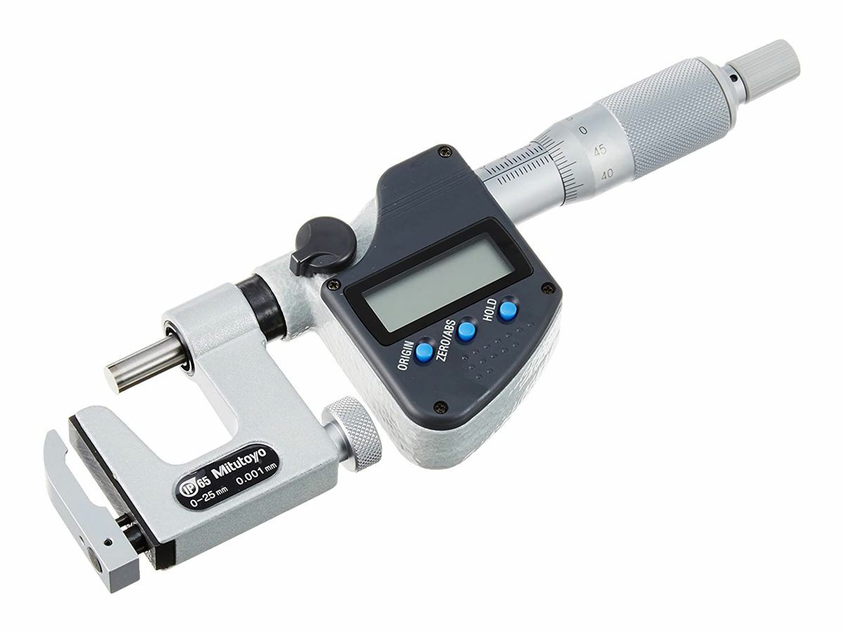

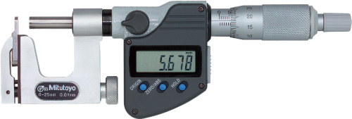

The Mitutoyo Digimatic Uni-Mike provides great versatility to acquire highly accurate measurements on many different types of workpieces. This micrometer has an IP65 dust and water protection level.
The Mitutoyo Uni-Mike digital micrometer features a clamp on the anvil side of the micrometer’s frame to allow the use of several different types of anvils. Depending on the type of anvil used, the Uni-Mike is proficient in measuring the thickness of tubes, rivet head heights, and shoulder-edge distances. A special disc anvil is available, which allows the Uni-Mike to operate similar to an indicator on a stand when measuring workpieces.
  • Metric models include a ratchet stop thimble with a constant measuring force
  • Supplied with a flat anvil and rod anvil
  • Special lapped disc anvils (optional).  The Uni-Mike can be used as a height micrometer
  • Carbide tips resist wear on the measuring faces for accurate measurements for an extended period of time
  • Certificate of Inspection is provided
  • Includes a standard bar except for 0-25mm and 0-1” models
