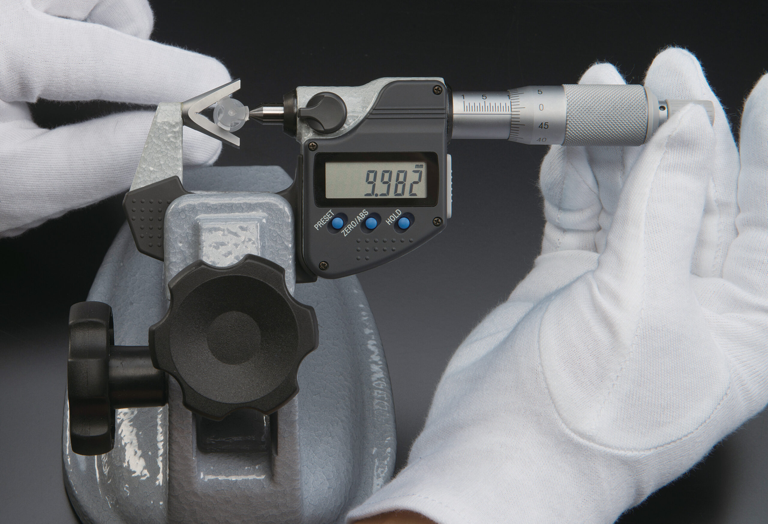

The Mitutoyo Digimatic V-Anvil micrometer measures the outside diameter of cutting tools such as taps, reamers and end mills with three flutes.
The Mitutoyo Digimatic V-Anvil digital micrometer pointed spindle and V-Anvil delivers precise position for highly accurate measurements. The anvil and spindle are precision milled from hardened steel for lasting, accurate results. A ratchet-stop mechanism provides uniform pressure on a workpiece for precise, repeatable measurements. Measurements are displayed on an easy-to-read LCD readout.

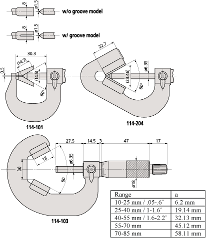

  • V-Anvils with a centerline groove are available for measuring the pitch diameter of taps by the single-wire method
  • Ratchet mechanism provides an audible click to ensure measurement is being performed with a constant force
  • Functions include Origin Set, Zero/ABS Setting, Data Hold, Data Output, 2 Presets, Function Lock, and inch/mm conversion (on inch/metric models only)

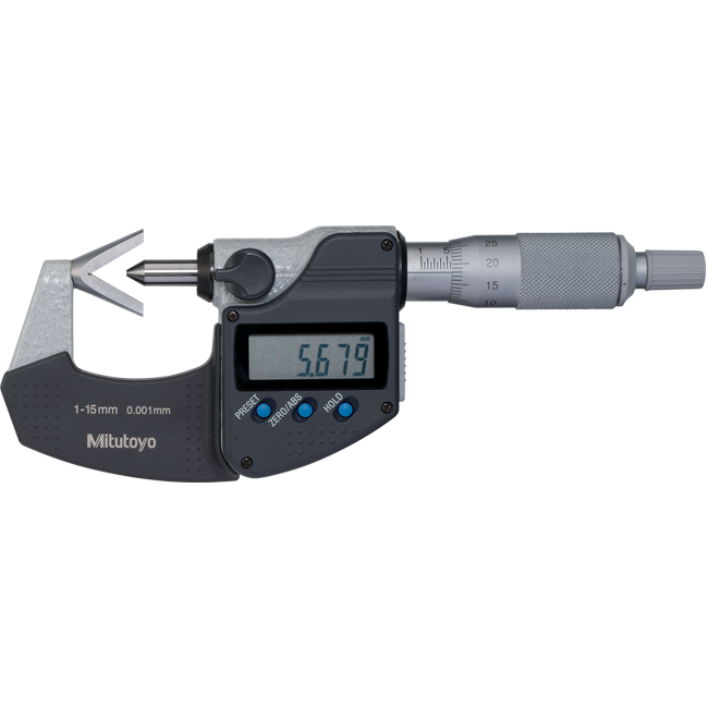

SERIES 314 Technical Data
Technology: Digimatic
SPC Output: Yes
Ratchet/Thimble: Ratchet Stop
Battery: SR44 (1 pc.) 938882
Remarks: 3-Flute
Order No.: Product Image: Units: Range: Resolution: Accuracy: Mass: Graduation: Remarks:
314-251-30 Metric 1-15mm 0.001mm ±4µm 275g 0.01mm w/Groove
314-252-30 - Metric 10-25mm 0.001mm ±4µm 410g 0.01mm w/Groove
314-253-30 - Metric 25-40mm 0.001mm ±5µm 465g 0.01mm -
314-261-30 - Metric 1-15mm 0.001mm ±4µm 275g 0.01mm -
314-262-30 - Metric 10-25mm 0.001mm ±4µm 410g 0.01mm -

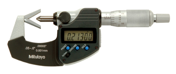

314-351-30 Metric, Inch .05-0.6" / 1.27-15.24mm 0.00005" / 0.001mm ±.0002" / ±4µm 275g 0.0010" / 0.01mm w/Groove
314-352-30 - Metric, Inch 0.4-1" / 10.16-25.4mm 0.00005" / 0.001mm ±.0002" / ±4µm 410g 0.0010" / 0.01mm w/Groove
314-353-30 - Metric, Inch 1-1.6" / 25.4-40.64mm 0.00005" / 0.001mm ±.00025" / ±5µm 465g 0.0010" / 0.01mm -
314-361-30 - Metric, Inch .05-0.6" / 1.27-15.24mm 0.00005" / 0.001mm ±.0002" / ±4µm 275g 0.0010" / 0.01mm -
314-362-30 - Metric, Inch 0.4-1" / 10.16-25.4mm 0.00005" / 0.001mm ±.0002" / ±4µm 410g 0.0010" / 0.01mm -
