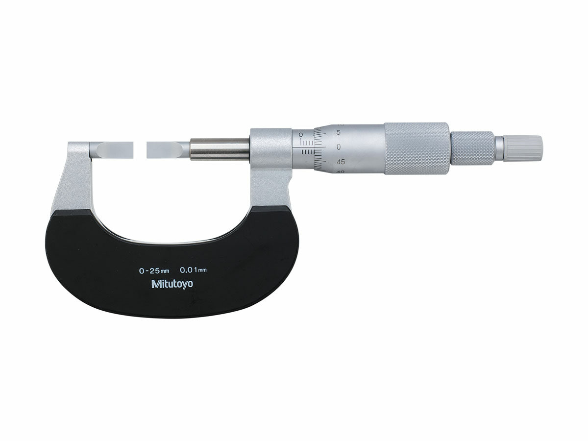

Blade Micrometer-Non-Rotating Spindle
The non-rotating spindle type blade micrometer quickly measures grooves, keyways and hard-to-reach areas with high accuracy. Available in inch or metric units.
The Mitutoyo mechanical blade micrometer utilizes a blade anvil and spindle for measuring difficult pieces such as groove diameters of shafts and keyways. The non-rotating spindle reduces torsion on softer parts being measured and prevents workpiece deformation and wear. A ratchet-stop mechanism provides uniform pressure on a workpiece for precise, repeatable measurements.
  • Ratchet thimble allows for easy single-hand use when measuring objects
  • Elimination of overspeed errors provides a higher measurement reliability and repeatability
  • Knurled friction thimbles provide quick adjustments even when wearing gloves
SERIES 122 Technical Data
Technology: Mechanical
SPC Output: No
Ratchet/Thimble: Ratchet Stop
Order No.: Product Image: Units: Range: Accuracy: Mass: Graduation: Anvil Type: Parallelism: Measuring Faces:
122-125-10 Inch 0-1" ±0.00015" 260g 0.0001" Type A 0.00015" or less -
122-126-10 - Inch 1-2" ±0.00015" 300g 0.0001" Type A 0.00015" or less -
122-127-10 Inch 2-3" ±0.00015" 360g 0.0001" Type A 0.00015" or less -
122-128-10 Inch 3-4" ±0.00020" 525g 0.0001" Type A 0.00020" or less -
122-151-10 Inch 0-1" ±0.00015" 275g 0.0001" TypevD 0.00015" or less Carbide tip
