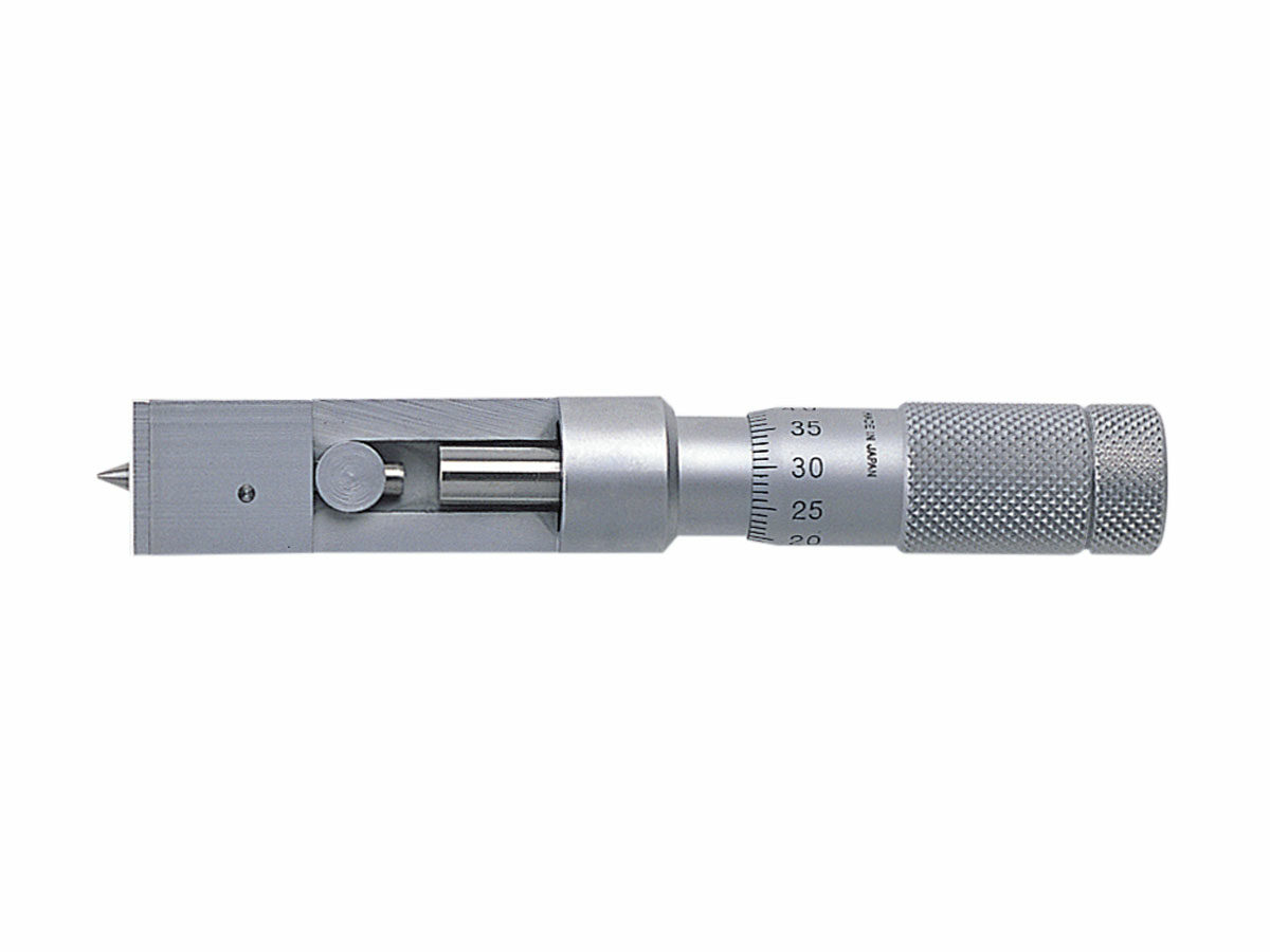

The Mitutoyo can seam micrometer takes precise measurements of width, height and depth of can seams. Micrometers are available for steel, aluminum and sprayer cans.
The Mitutoyo can seam micrometer is constructed with high-grade tool steel in our own manufacturing facilities in Japan, ensuring the micrometer is made to our precise standards. The micrometer’s ratchet-stop mechanism provides uniform pressure on a workpiece for precise, repeatable measurements. An inch Vernier scale provides precise outside diameter measurements.
  • Micrometers are available for steel, aluminum and sprayer cans
  • The spindle and anvils are constructed of hardened steel for durability
  • Supplied in fitted carton
