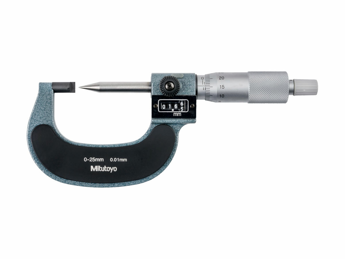

The Mitutoyo mechanical crimp height micrometer is designed to measure the height of electrical crimp contacts.
Series 142
Crimp Height Micrometer-Counter
The Mitutoyo crimp height micrometer measures the contact height of a connector once crimped with a wire. The micrometer’s pointed spindle and blade anvil delivers precise position for highly accurate measurements. A mechanical digit counter displays readings to .0001” for easier viewing and recording. A ratchet-stop mechanism provides uniform pressure on a workpiece for precise, repeatable measurements.
- Ratchet mechanism provides an audible click to ensure measurement is being performed with a constant force
- Vernier scale graduated to .001” on the thimble allows precise outer dimension measurements
- A spindle lock provides a secure locking of the measurement position for easier recording
- Frame is constructed of high-grade steel and has a baked enamel finish for durability
