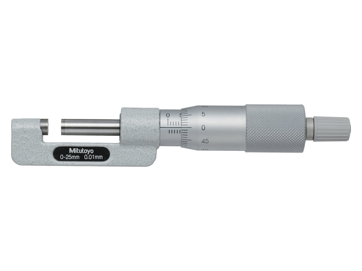

The Mitutoyo hub micrometer is designed for precise measurements of hub thickness and shoulder inside a bore.
View Dimensions
The Mitutoyo hub micrometer features high-grade hardened steel on its frame, spindle and anvil to deliver precise, repeatable thickness and shoulder measurements. The micrometer’s ratchet-stop mechanism provides uniform pressure on a workpiece for precise, repeatable measurements. An inch Vernier scale provides outside diameter measurements.
  • Measuring surfaces on the anvil and spindle are constructed of carbide to reduce wear
  • Includes a standard bar except for 0-25mm / 0-1” model

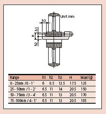

SERIES 147 Technical Data
Technology: Mechanical
Ratchet/Thimble: Ratchet Stop
Order No.: Product Image: Units: Range: Accuracy: Mass: Graduation: Flatness: Parallelism:
147-301 Metric 0-25mm ±2µm 135g 0.01mm 0.6µm 3µm or less
147-302 - Metric 25-50mm ±2µm 150g 0.01mm 0.6µm 3µm or less
147-303 - Metric 50-75mm ±2µm 170g 0.01mm 0.6µm 3µm or less
147-304 - Metric 75-100mm ±3µm 185g 0.01mm 0.6µm 3µm or less
147-351 Inch 0-1" ±0.00010" 135g 0.001" - 0.00012" or less
147-352 Inch 1-2" ±0.00010" 150g 0.001" - 0.00012" or less
147-353 - Inch 2-3" ±0.00010" 170g 0.001" - 0.00012" or less
147-354 - Inch 3-4" ±0.00015" 185g 0.001" - 0.00012" or less
