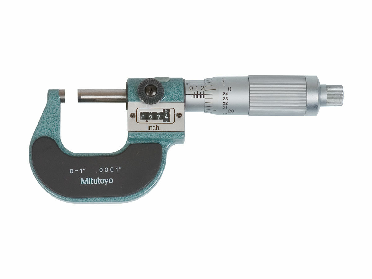

The Mitutoyo outside micrometer delivers highly accurate measurements down to .0001” resolution with the Vernier scale. The mechanical digit counter with 0.01mm or .001” readings provides quick, error-free readings.
View Dimensions
The Mitutoyo outside micrometer with mechanical digit counter features a ratchet-stop mechanism helps provide uniform pressure on a workpiece for precise, repeatable measurements. The frame has a satin chrome finish for durability, and measurements on the thimble and conversions on the frame are laser etched for easier reading. A Vernier scale with slanted barrel markings to help reduce parallax errors provides highly accurate outside diameter measurements.
  • Available in Inch models
  • The micrometer’s friction thimble provides smooth uniform pressure on a workpiece for precise, repeatable measurements.
  • Mechanical digit counter allows easy measurement readings to 0.01mm
  • A spindle lock provides secure locking of the measurement position
  • Satin chrome finish on the thimble and sleeve resists rust and reduces glare
  • Includes a standard bar except for 0-25mm / 0-1” model

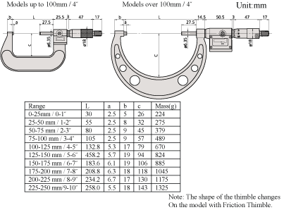

SERIES 193 Technical Data
Technology: Digit counter
Units: Inch
Accuracy: ±0.00010"
Ratchet/Thimble: Friction Thimble
Graduation: 0.0001"
Flatness: -
Parallelism: 0.00008" or less
Remarks: .0001 reading is obtained with vernier
Order No.: Product Image: Range: Mass:
193-211 0-1" 224g
193-212 - 1-2" 275g
