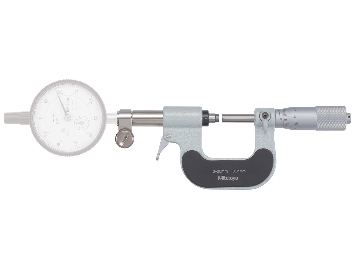

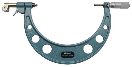

The Mitutoyo outside micrometer with a retracting anvil trigger offers faster spindle retraction to a set measurement, while increasing throughput accuracy. A hardened steel sleeve securely holds a dial indicator for almost instant GO/NO-GO judgments on parts or workpieces. A ratchet-stop mechanism  provides uniform pressure on a workpiece for precise, repeatable measurements.
  • A precision machined spring provides smooth and easy anvil trigger operation
  • Scale is laser etched on thimble for easier reading
  • Includes a standard bar except for 0-25mm models

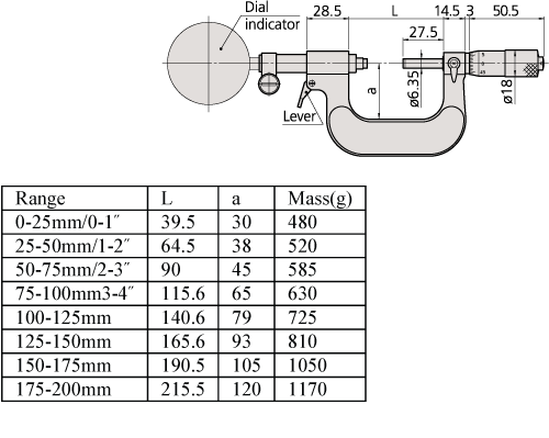

SERIES 107 Technical Data
Technology: Mechanical
Units: Metric
Accuracy: ±3µm
SPC Output: No
Ratchet/Thimble: Plain Thimble
Graduation: 0.01mm
Flatness: 0.6µm
Order No.: Product Image: Range: Mass: Parallelism:
107-201 0-25mm 480g 2µm or less
107-202 - 25-50mm 520g 2µm or less
107-203 - 50-75mm 585g 2µm or less
107-204 - 75-100mm 630g 3µm or less
107-205 - 100-125mm 725g 3µm or less
107-206 - 125-150mm 810g 3µm or less
107-207 150-175mm 1050g 3µm or less
107-208 - 175-200mm 1170g 4µm or less
