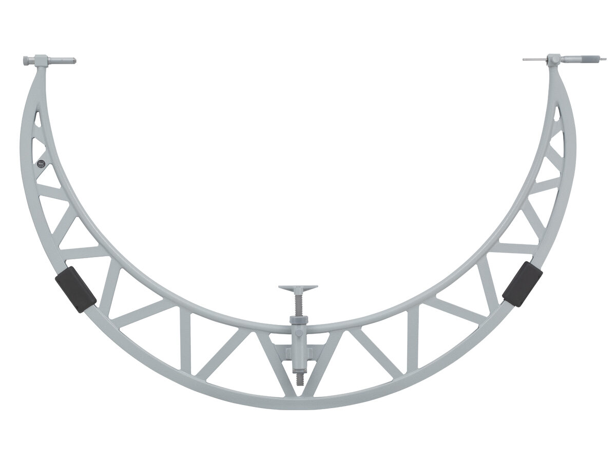

The Mitutoyo outside micrometer with extension anvil collars and 50mm spindle stroke provides a wide measuring range without compromising accuracy. Available in inch and metric measurements.
The Mitutoyo large-span ratchet stop outside micrometer is ideal for measuring metal and non-metal workpieces by controlling the amount of spindle force. A ratchet-stop mechanism helps provide uniform pressure on a workpiece for precise, repeatable measurements.
  • Available in inch and metric models
  • Workpiece stopper keeps workpieces centered properly for consistent, accurate measurements (on 1000mm range models only)
  • Square and round pipes are combined to keep the frame rigid and lightweight for easier use (for models over 1000mm range)
  • Measurements are laser etched on thimble for easier reading
  • Supplied in a fitted wooden case
