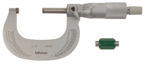

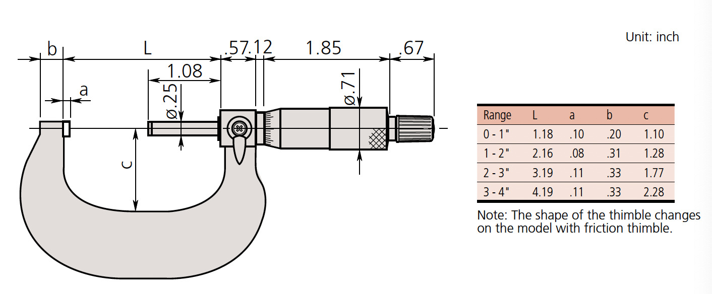

The Mitutoyo outside micrometer with a tapered frame is able to measure in tight spaces and narrow slots. Available with a ratchet-stop or friction thimble.
The Mitutoyo 101 series outside micrometer is ideal for measuring in tight spaces and narrow slots attributed to the taper of its frame on the anvil side. Available with a ratchet-stop mechanism or friction thimble for smooth, uniform pressure on a workpiece making it precise, repeatable measurements easier. The frame has a satin chrome finish for durability, and measurements are laser etched for easier reading.
  • A spindle lock provides secure locking of the measurement position
  • Measurements are laser etched on thimble for faster, easier readings
  • Conversion charts are laser etched on the frame
  • Satin chrome finish helps resist rust and reduces glare
  • Includes a standard bar except for 0-1” models
SERIES 101 Technical Data
Technology: Mechanical
Units: Inch
SPC Output: No
Graduation: 0.0001"
Flatness: -
Order No.: Product Image: Range: Accuracy: Ratchet/Thimble: Mass: Parallelism:
101-113 0-1" ±.0001" Ratchet Stop 180g 0.00008" or less
101-114 1-2" ±.0001" Ratchet Stop 245g 0.00008" or less
101-117 0-1" ±.0001" Friction Thimble 180g 0.00008" or less
101-118 1-2" ±.0001" Friction Thimble 245g 0.00008" or less
101-119 2-3" ±.0001" Ratchet Stop 410g 0.00008" or less
101-120 - 3-4" ±.00015" Ratchet Stop 550g 0.00012" or less
