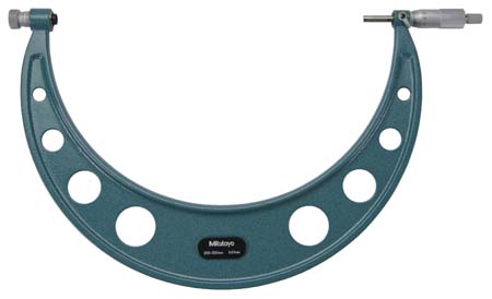

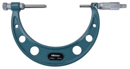

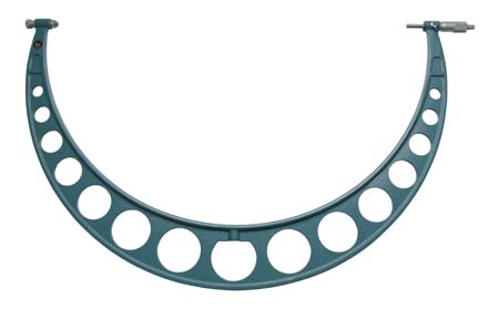

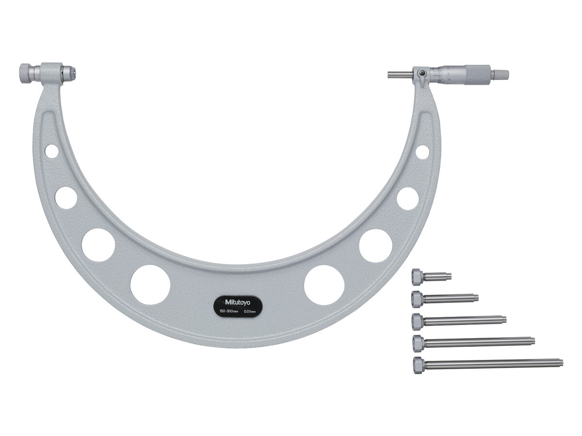

The Mitutoyo metric outside micrometer features a ratchet stop function and interchangeable anvils for measuring a wide range of workpiece sizes and material types with precision. Available in metric measurements.
The Mitutoyo ratchet stop outside micrometer in metric scale is ideal for measuring metal and non-metal workpieces by controlling the amount of force applied by the spindle. A ratchet-stop mechanism provides uniform pressure on a workpiece for precise, repeatable measurements. Interchangeable anvils allow for measuring a wide range of workpiece sizes.
  • Metric scale is laser etched on thimble for fast and easy reading
  • Carbide facing on the spindle resists wear to keep surfaces flatter with longer accuracy
  • Supplied in a fitted wooden case
Technology: Mechanical
Units: Metric
SPC Output: No
Ratchet/Thimble: Ratchet Stop
Graduation: 0.01mm
Measuring Force: 5-10N
