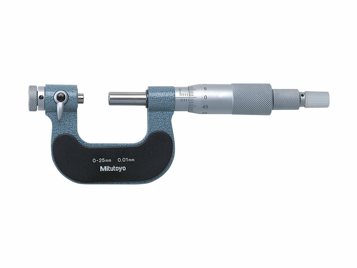

With seven optional interchangeable anvils, the Mitutoyo pana micrometers offer precise measurements for a wide variety of applications. Available in inch or metric units.
The Mitutoyo pana micrometer delivers great versatility to measure outside diameters of many different types of workpieces by interchanging anvils. The non-rotating spindle reduces torsion on softer parts being measured to prevent workpiece deformation and wear and offers steady positioning during measurement. A ratchet-stop mechanism provides uniform pressure on a workpiece for precise, repeatable measurements.
  • V-Anvils and conical spindle tips (matching pair) for screw thread measurement are also available
  • Non-rotating spindle with optional seven interchangeable anvils (flat, spline, spherical, point, knife-edge, disk, and blade) for a wide range of applications
  • Measuring surfaces are constructed of carbide for exceptional flatness and lasting durability
  • Ratchet mechanism provides an audible click to ensure measurement performs at a constant force
  • Knurled friction thimbles provides quick adjustments even when wearing gloves
  • Includes a standard bar except for the 0-25mm and 0-1” model
