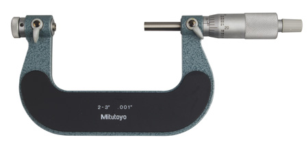

Screw Thread Micrometer-Interchangeable
The Mitutoyo screw thread micrometer uses interchangeable anvils and spindle to perform accurate measurement of different types of screw thread pitch diameters faster and easier.

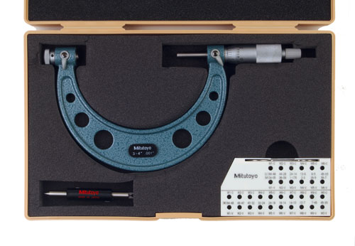

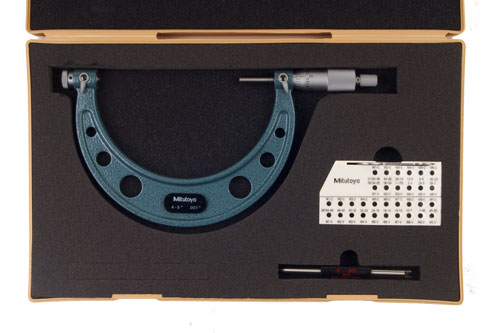

The Mitutoyo screw thread micrometer uses optional V-Anvil and conical spindle inserts interchangeably to precisely measure pitch diameters of metric or unified screw threads. A ratchet-stop mechanism provides uniform pressure on a workpiece for precise, repeatable measurements.
  • Optional interchangeable 60 degree and 55 degree V-Anvil and conical spindle inserts are precision ground hardened, high-grade steel
  • Includes a standard bar except for 0-25mm and 0-1” models

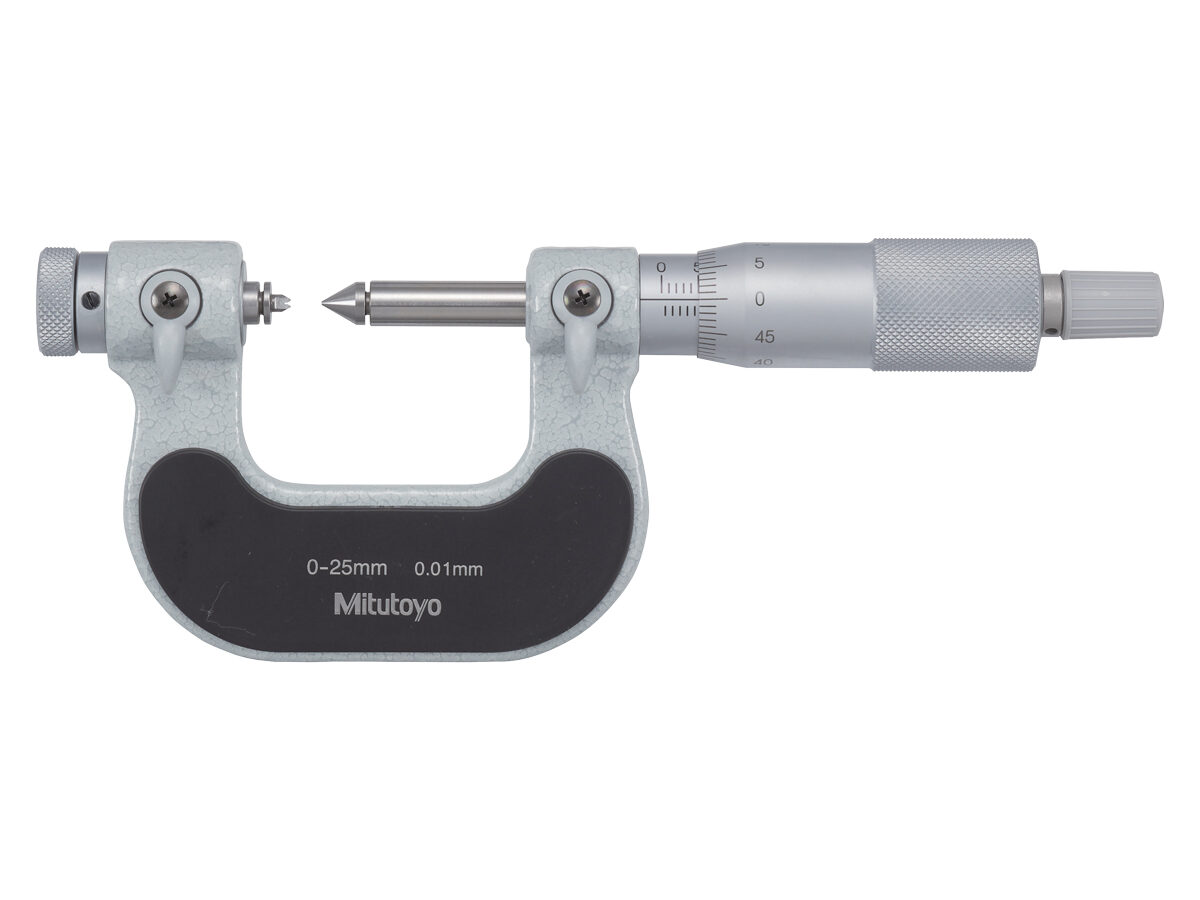

126-125 - Metric 0-25mm 3µm 240g 0.01mm

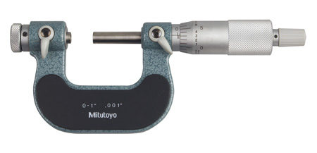

126-137 Inch 0-1" 0.00015" 240g 0.001"

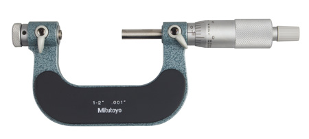

126-138 Inch 1-2" 0.00015" 290g 0.001"
