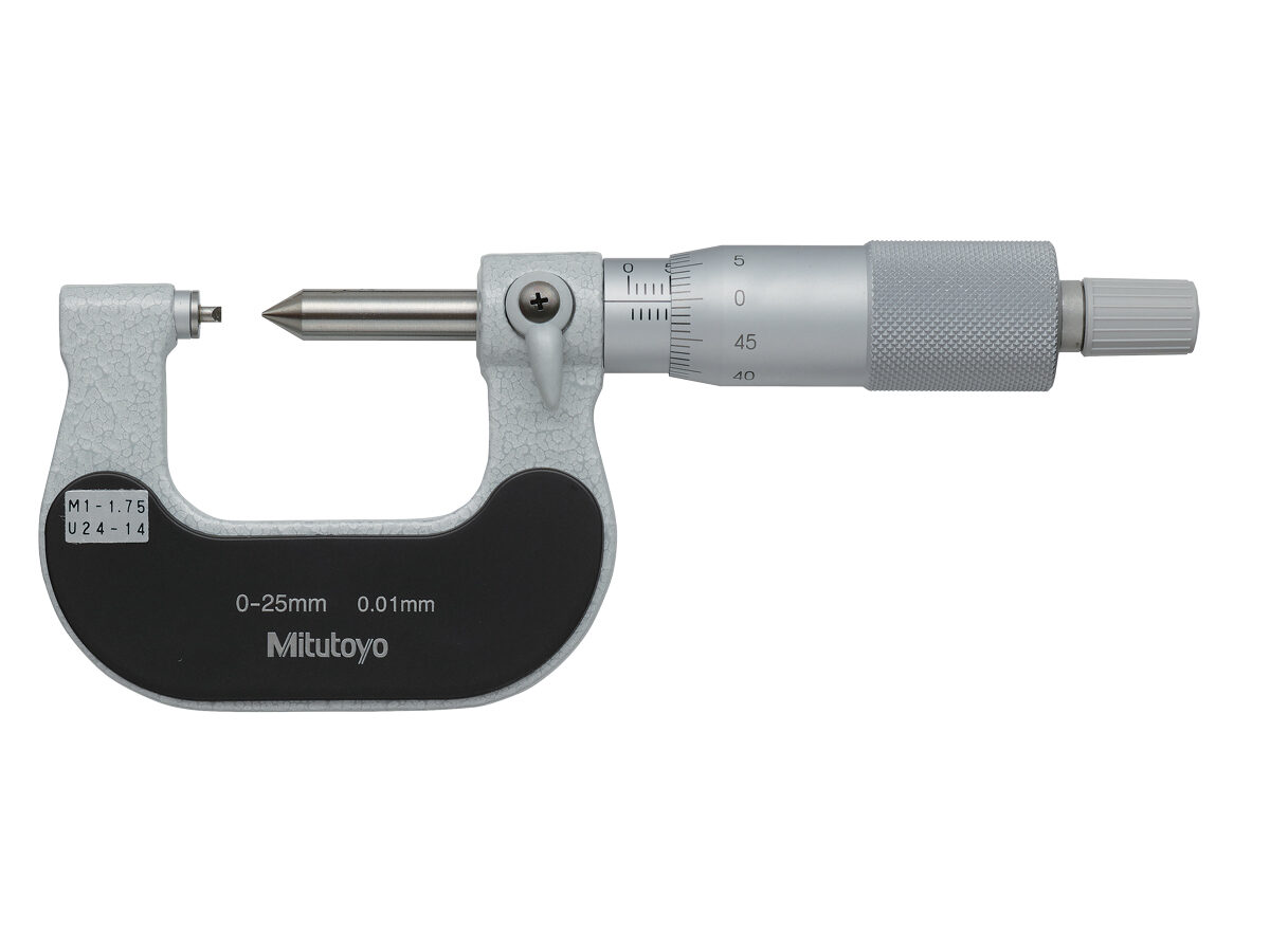

The Mitutoyo mechanical screw thread micrometer makes measuring screw thread pitch diameters easy and highly accurate.
View Dimensions
The Mitutoyo screw thread micrometer features a hardened steel 60 degree anvil and conical spindle to easily and precisely measure pitch diameters of metric or unified screw threads. A ratchet-stop mechanism provides uniform pressure on a workpiece for precise, repeatable measurements.
  • Measuring surfaces are constructed of carbide to reduce wear
  • Satin chrome finish on the sleeve and laser etched scale on thimble for easier reading
  • Includes a standard bar for zero-point adjust except for 0-25mm model

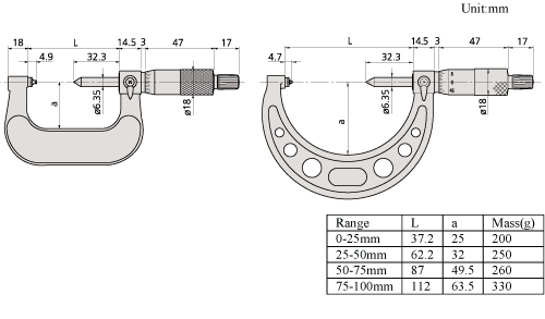

SERIES 125 Technical Data
Technology: Mechanical
Units: Metric
Ratchet/Thimble: Ratchet Stop
Graduation: 0.01mm
Spindle Feed Error: 3µm
Order No.: Product Image: Range: Mass: Screw to be Measured:
125-101 - 0-25mm 200g 0.4 - 0.5mm / 64 - 48TPI
125-102 - 0-25mm 200g 0.6 - 0.9mm / 44 - 28TPI
125-103 0-25mm 200g 1 - 1.75mm / 24 - 14TPI
125-104 - 0-25mm 200g 2 - 3mm / 13 - 9TPI
125-105 - 0-25mm 200g 3.5 - 5mm / 8 - 5TPI
125-106 - 25-50mm 250g 0.4 - 0.5mm / 64 - 48TPI
125-107 - 25-50mm 250g 0.6 - 0.9mm / 44 - 28TPI
125-108 - 25-50mm 250g 1 - 1.75mm / 24 - 14TPI
125-109 - 25-50mm 250g 2 - 3mm / 13 - 9TPI
125-110 - 25-50mm 250g 3.5 - 5mm / 8 - 5TPI
125-111 - 50-75mm 260g 0.6 - 0.9mm / 44 - 28TPI
125-112 - 50-75mm 260g 1 - 1.75mm / 24 - 14TPI
125-113 - 50-75mm 260g 2 - 3mm / 13 - 9TPI
125-114 - 50-75mm 260g 3.5 - 5mm / 8 - 5TPI
125-115 - 50-75mm 260g 5.5 - 7mm / 4.5 - 3.5TPI
125-116 - 75-100mm 330g 0.6 - 0.9mm / 44 - 28TPI
125-117 - 75-100mm 330g 1 - 1.75mm / 24 - 14TPI
125-118 - 75-100mm 330g 2 - 3mm / 13 - 9TPI
125-119 - 75-100mm 330g 3.5 - 5mm / 8 - 5TPI
125-120 - 75-100mm 330g 5.5 - 7mm / 4.5 - 3.5TPI
