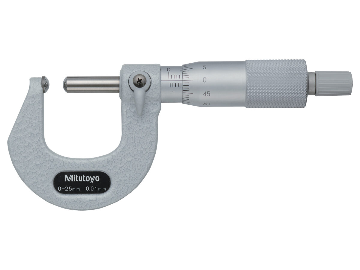

The Mitutoyo spherical face micrometer measures the thickness of curved parts within +/- 0.0001” of accuracy. Available in inch or metric units.
Series 115
Spherical Face Micrometer-Spherical Anvil & Spindle
The Mitutoyo spherical micrometer is available with either a spherical face on the anvil and a flat spindle measuring surface or with spherical measuring surfaces on the anvil and spindle, depending on the application. A ratchet-stop mechanism provides uniform pressure on a workpiece for precise, repeatable measurements and eliminates over-speed error. The micrometer has a measurement range of 0 to 1.0″ (0 to 25.4mm), resolution of 0.00005″ (0.001mm), and an accuracy of +/- 0.0001″
- Available with spherical anvil and flat spindle or with spherical anvil and spherical spindle
- Designed to measure the wall thickness of various tubing, curved parts and pipe wall thickness
- Spherical measuring faces are 0.59” in diameter and carbide-tipped for durability
- Ratchet mechanism provides an audible click to ensure measurement is performed at a constant force
- Knurled friction thimbles provide quick adjustments even when wearing gloves
- Satin chrome finish on the sleeve and laser etched scale on thimble for easier reading
- Frame has a baked enamel finish for durability and longer lifespan
- Includes a standard bar except for 0-25mm and 0-1” models
