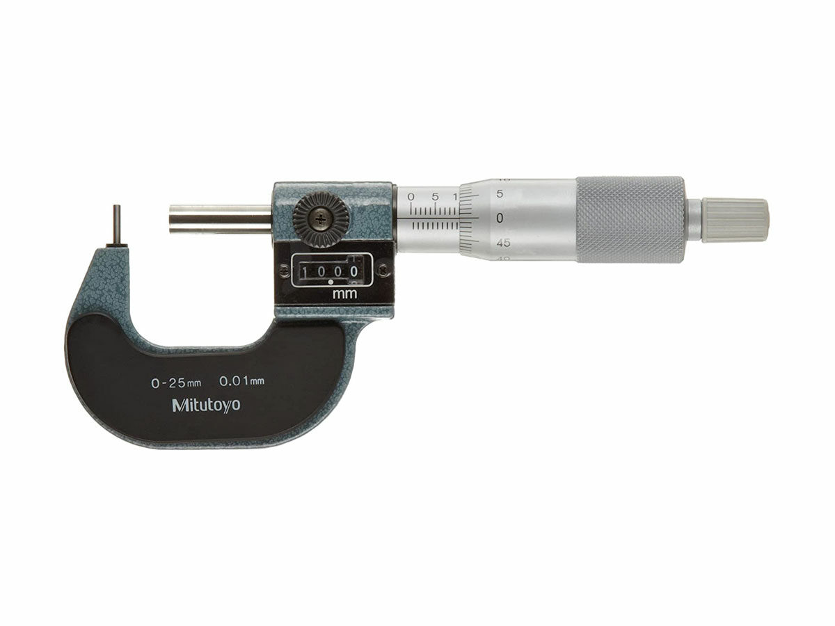

The Mitutoyo spherical face micrometer measures the thickness of tube walls within +/- 0.00015” of accuracy and displays readings on an analog digit counter. Available in inch or metric units.
The Mitutoyo tube micrometer is available with either flat or spherical measuring face options to measure the wall thickness of various tubes. A ratchet-stop mechanism provides uniform pressure on a workpiece for precise, repeatable measurements and eliminates over-speed error.

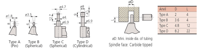

- Available with pin, spherical and cylindrical anvils
- Measurements are displayed on the micrometer’s frame with a mechanical analog digit counter
- Model with a perpendicular cylindrical anvil are available
- Designed to measure the wall thickness of various tubing
- Measuring surfaces are constructed of carbide to reduce wear
- Ratchet mechanism provides an audible click to ensure measurement is being performed at a constant force
- Frame has a non-slip finish for better grip in shop environments
- Includes a standard bar except for the 0-25mm and 0-1” model
SERIES 295 Technical Data
Technology: | Mechanical Counter |
SPC Output: | No |
Ratchet/Thimble: | Rachet Stop |
Flatness: | 0.3µm |
Order No.: | Product Image: | Units: | Range: | Accuracy: | Mass: | Graduation: | Remarks: |
295-302 | - | Metric | 0-25mm | ±3µm | 210g | 0.01mm | Type A |
295-313 | - | Inch | 0-1" | ±.00015" | 210g | 0.0001" | Type C |
295-314 | - | Inch | 0-1" | ±.00015" | 2310g | 0.0001" | Type D |
