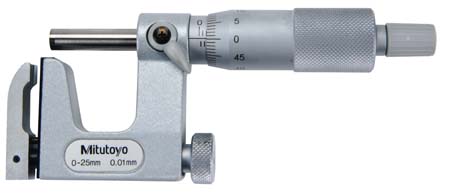

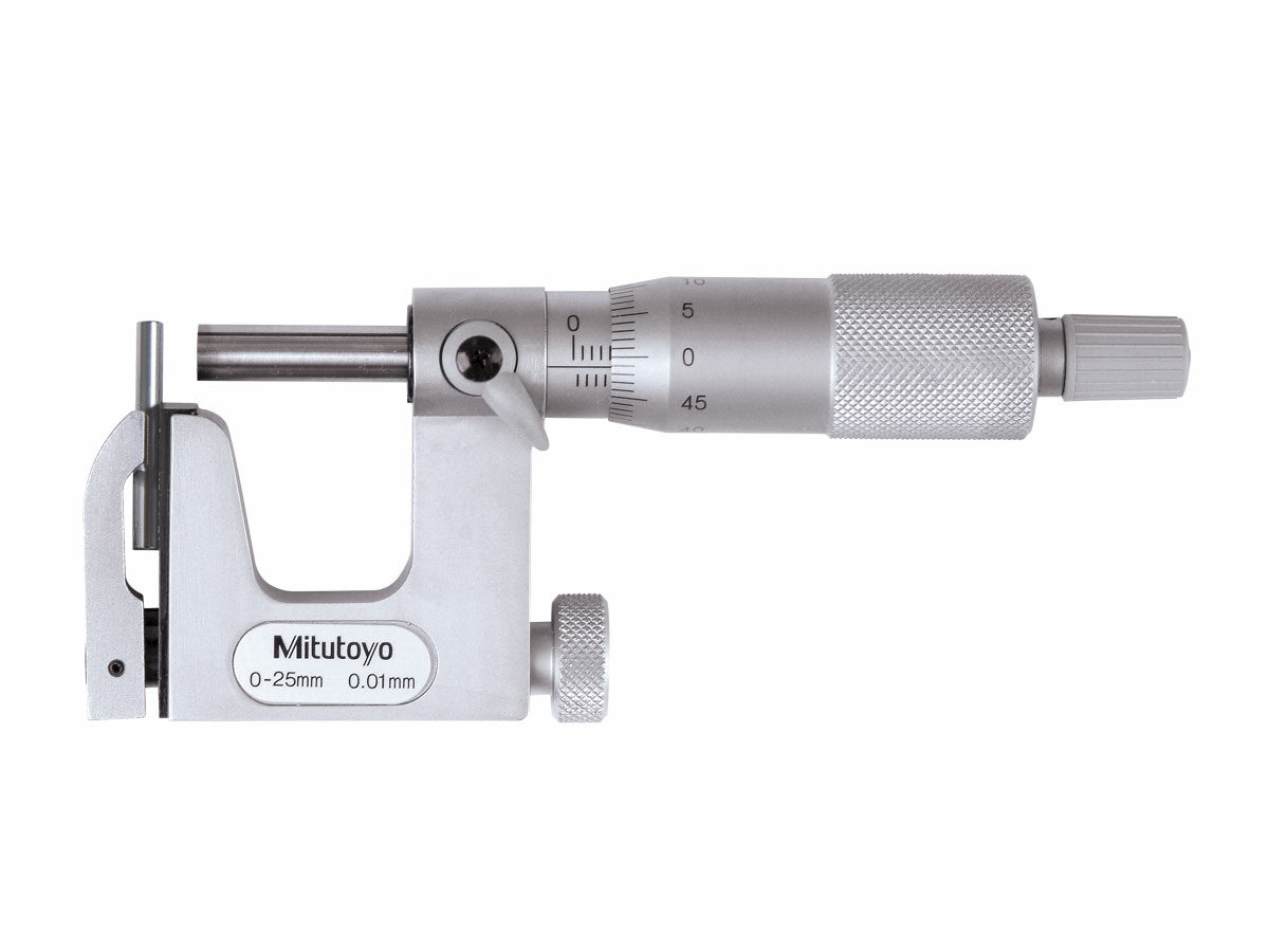

The Mitutoyo Uni-Mike provides great versatility to take highly accurate measurements on many different types of workpieces.
The Mitutoyo Uni-Mike micrometer features a clamp on the anvil side of the micrometer’s frame to allow the use of several different types of anvils. Depending on the type of anvil used, the Uni-Mike is proficient at measuring the thickness of tubes, rivet head heights, and shoulder-edge distances. A special disc anvil is available which allows the Uni-Mike to function similar to an indicator on a stand for measuring the height or thickness of workpieces.
  • Metric models include a ratchet stop thimble with a constant measuring force
  • Inch models include a friction thimble with a constant measuring force
  • Supplied with a flat anvil and rod anvil
  • Carbide tips resist wear on the measuring faces for accurate measurements for an extended period of time
  • Knurled friction thimbles provides quick adjustments even when wearing gloves
  • Certificate of Inspection is provided
SERIES 117 Technical Data
Technology: Mechanical
Units: Metric
Accuracy: ±4µm
SPC Output: No
Ratchet/Thimble: Rachet Stop
Graduation: 0.01mm
Parallelism: 3µm or less

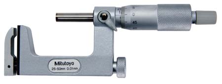

117-101 0-25mm 255g -
117-102 25-50mm 320g -
