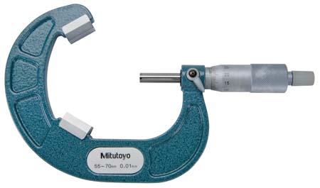

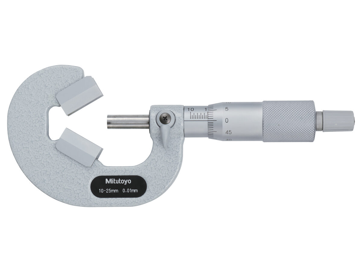

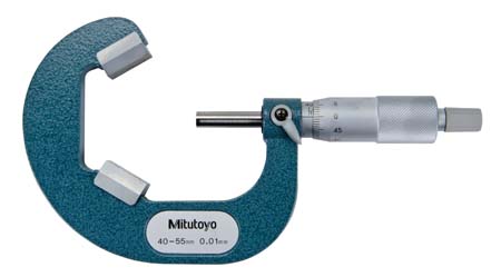

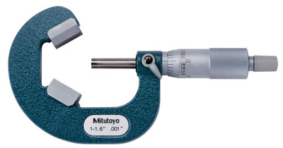

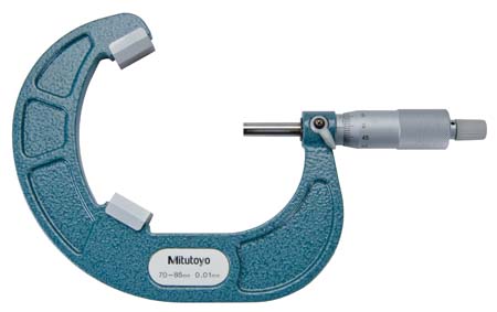

The Mitutoyo mechanical V-Anvil micrometer with a ratchet-stop that is used for measuring the outside diameter of cutting tools.
V-Anvil Micrometer-3 Flutes
The Mitutoyo mechanical V-Anvil micrometer measures the outside diameter of cutting tools such as taps, reamers and end mills with three flutes. Available in inch or metric units.
The Mitutoyo V-Anvil micrometer pointed spindle and V-Anvil delivers precise position for highly accurate measurements. The anvil and spindle are precision milled from hardened steel for lasting, accurate results. A ratchet-stop mechanism provides uniform pressure on a workpiece for precise, repeatable measurements.
  • Available in Metric or Inch models
  • V-Anvils with a centerline groove are available for measuring the pitch diameter of taps by the single-wire method
  • Ratchet mechanism provides an audible click to ensure measurement is being performed at a constant force
SERIES 114 Technical Data
Technology: Mechanical
SPC Output: No
Remarks: 3-Flute
Order No.: Product Image: Units: Range: Accuracy: Mass: Graduation: Remarks:
114-101 - Metric 1-15mm ±4µm 120g 0.01mm w/Groove
114-102 - Metric 10-25mm ±4µm 280g 0.01mm w/Groove
114-103 - Metric 25-40mm ±5µm 400g 0.01mm -
114-104 Metric 40-55mm ±6µm 465g 0.01mm -
114-105 Metric 55-70mm ±6µm 675g 0.01mm -
114-106 Metric 70-85mm ±7µm 910g 0.01mm -
114-113 Inch 1-1.6" ±.00025" 400g 0.0010" -
114-114 - Inch 1.6-2.2" ±.0003" 465g 0.0010" -
114-161 - Metric 1-15mm ±4µm 120g 0.01mm -
114-163 - Inch .05-0.6" ±.0002" 120g 0.0010" -
114-202 Inch .09-1" ±.0002" 280g 0.0001" -
114-204 Metric 2.3-25mm ±4µm 290g 0.01mm -
