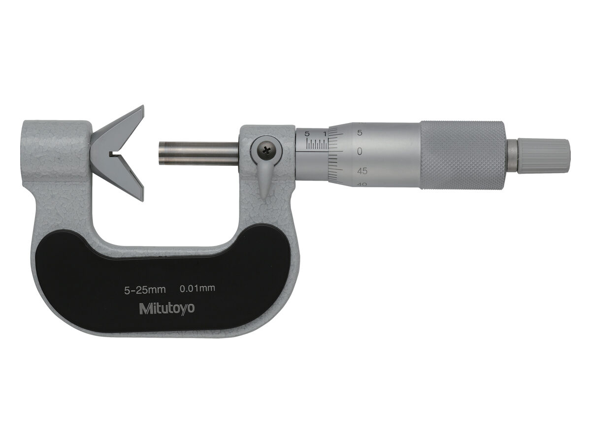

V-Anvil Micrometer-5 Flutes
The Mitutoyo mechanical V-Anvil micrometer measures the outside diameter of cutting tools such as taps, reamers and end mills with five flutes. Available in inch or metric units.
The Mitutoyo V-Anvil micrometer pointed spindle and V-Anvil delivers precise position for highly accurate measurements. The anvil and spindle are precision milled from hardened steel for lasting, accurate results. A ratchet-stop mechanism provides uniform pressure on a workpiece for precise, repeatable measurements.
  • Available in Metric or Inch models
  • V-Anvils with a centerline groove are available for measuring the pitch diameter of taps by the single-wire method
  • Ratchet mechanism provides an audible click to ensure measurement performs with a constant force
SERIES 114 Technical Data
Technology: Mechanical
SPC Output: No
Remarks: 5-Flute
Order No.: Product Image: Units: Range: Accuracy: Mass: Graduation: Remarks:
114-121 Metric 5-25mm ±4µm 255g 0.01mm w/Groove
114-122 - Metric 25-45mm ±5µm 400g 0.01mm -
114-123 Metric 45-65mm ±6µm 540g 0.01mm -
114-124 - Metric 65-85mm ±7µm 760g 0.01mm -
114-135 Inch .09-1" ±.0002" 255g 0.0001" -
114-137 - Metric 2.3-25mm ±4µm 220g 0.01mm -
114-165 - Metric 5-25mm ±4µm 255g 0.01mm -
