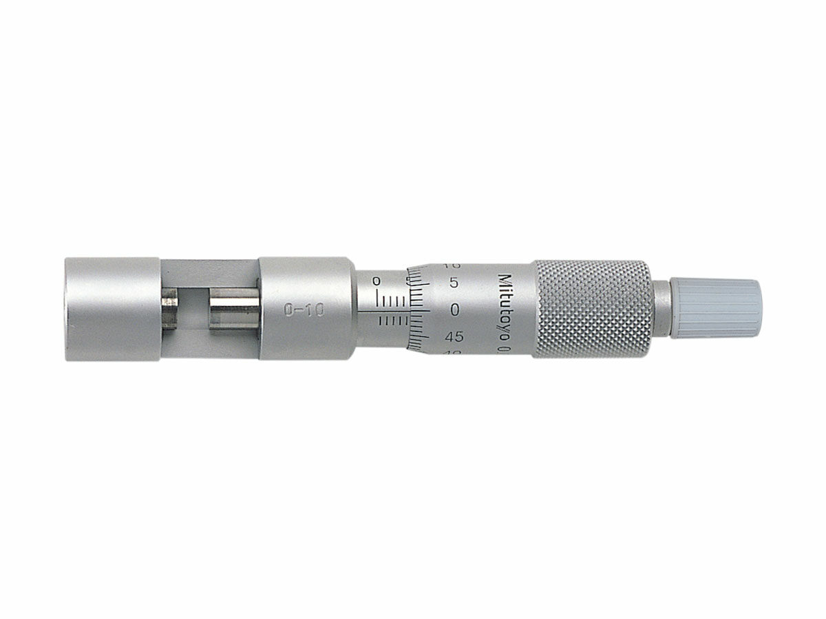

The Mitutoyo wire thickness micrometer is designed for precise measurement of wire thickness and diameters of small balls.
View Dimensions
The Mitutoyo wire thickness micrometer features high-grade hardened steel on its frame, spindle and anvil to deliver precise, repeatable wire thickness and small ball diameters. The micrometer’s ratchet-stop mechanism delivers uniform pressure on a workpiece for precise, repeatable measurements. An inch Vernier scale provides outside diameter measurements.
  • A measuring range of 0-10mm with 0.10mm graduation and +/- 0.003mm accuracy provides exceptionally precise and accurate measurements
  • Measuring surfaces on the anvil and spindle are constructed of carbide to reduce wear

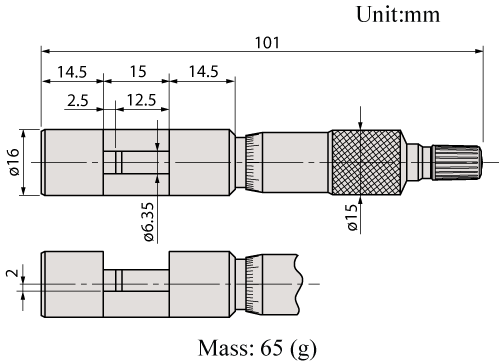

SERIES 147 Technical Data
Technology: Mechanical
Mass: 65g
Order No.: Product Image: Units: Range: Accuracy: Graduation: Flatness: Parallelism:
147-401 Metric 0-10mm ±3µm 0.01mm 0.6µm 1.3µm or less
147-402 Inch 0-0.4" ±0.00015" 0.0001" - 0.00005" or less
