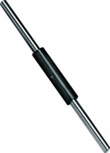

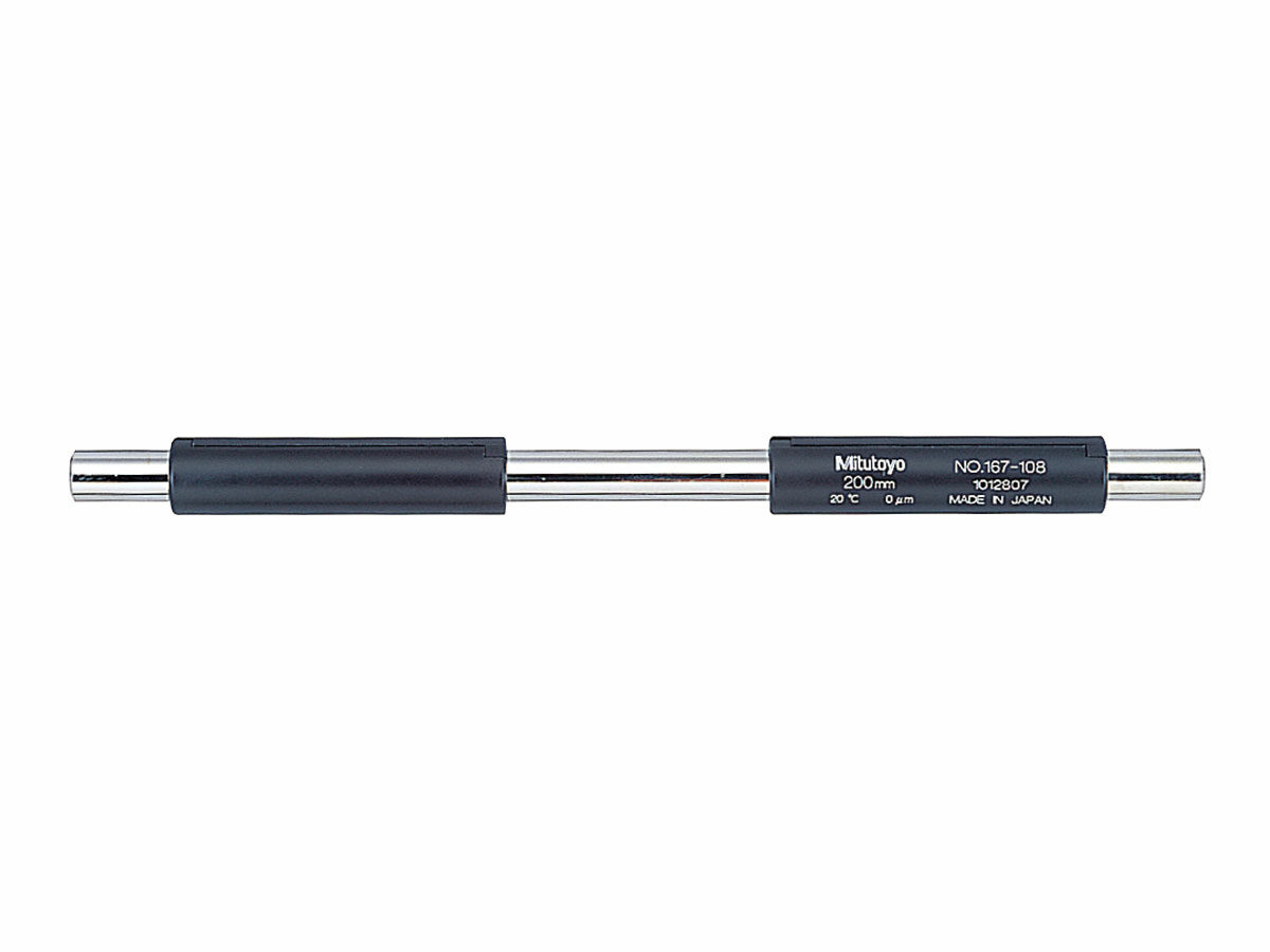

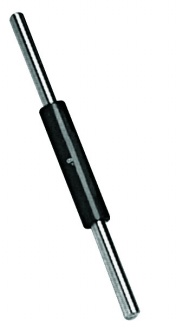

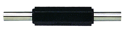

Mitutoyo micrometer standards ensure your outside micrometers are zero set with precision to better ensure your measurements are accurate and repeatable.
The Mitutoyo micrometer standards are built with the same precision as our micrometers to reliably set the zero point on outside micrometers. The standard’s measuring faces are exceptionally flat and lapped for precise, repeatable measurements over time. The handle is heat insulated to prevent expansion due to body temperature.
  • Available in Metric lengths from 25mm to 1000mm
  • Available in Inch lengths from 1” to 79”
  • Supplied in fitted carton for standards up to 500mm/20” in length
  • Supplied in wooden case for standards over 525mm/21” in length
