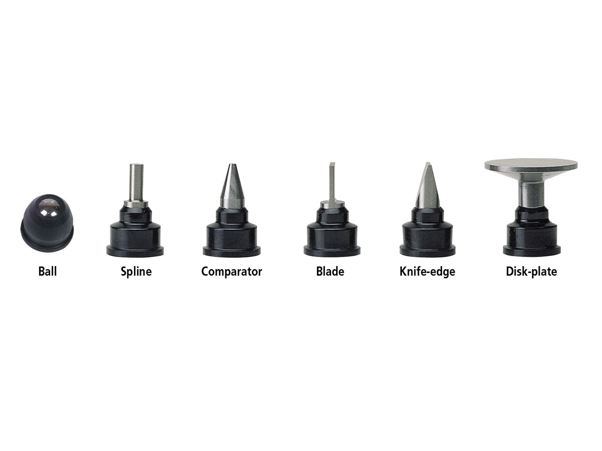

Several different spindle attachment tips allow Mitutoyo micrometers to measure odd-shaped workpieces.
Spindle Attachment Tips

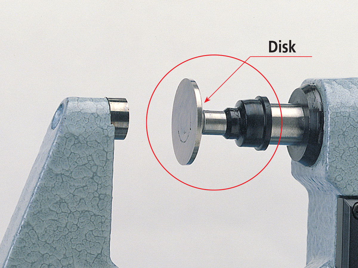

Optional Mitutoyo micrometer spindle attachment tips help measure odd workpieces and other part features a specific micrometer wasn’t designed to measure such as cylindrical wall thickness or into grooves, etc.
- Attachments include: ball, spline, comparator, blade, knife-edge and disc
- Ball attachments are made of hardened steel with .200” and .250” diameters which are placed on .250” and .315” diameter anvils, respectively, by rubber caps
