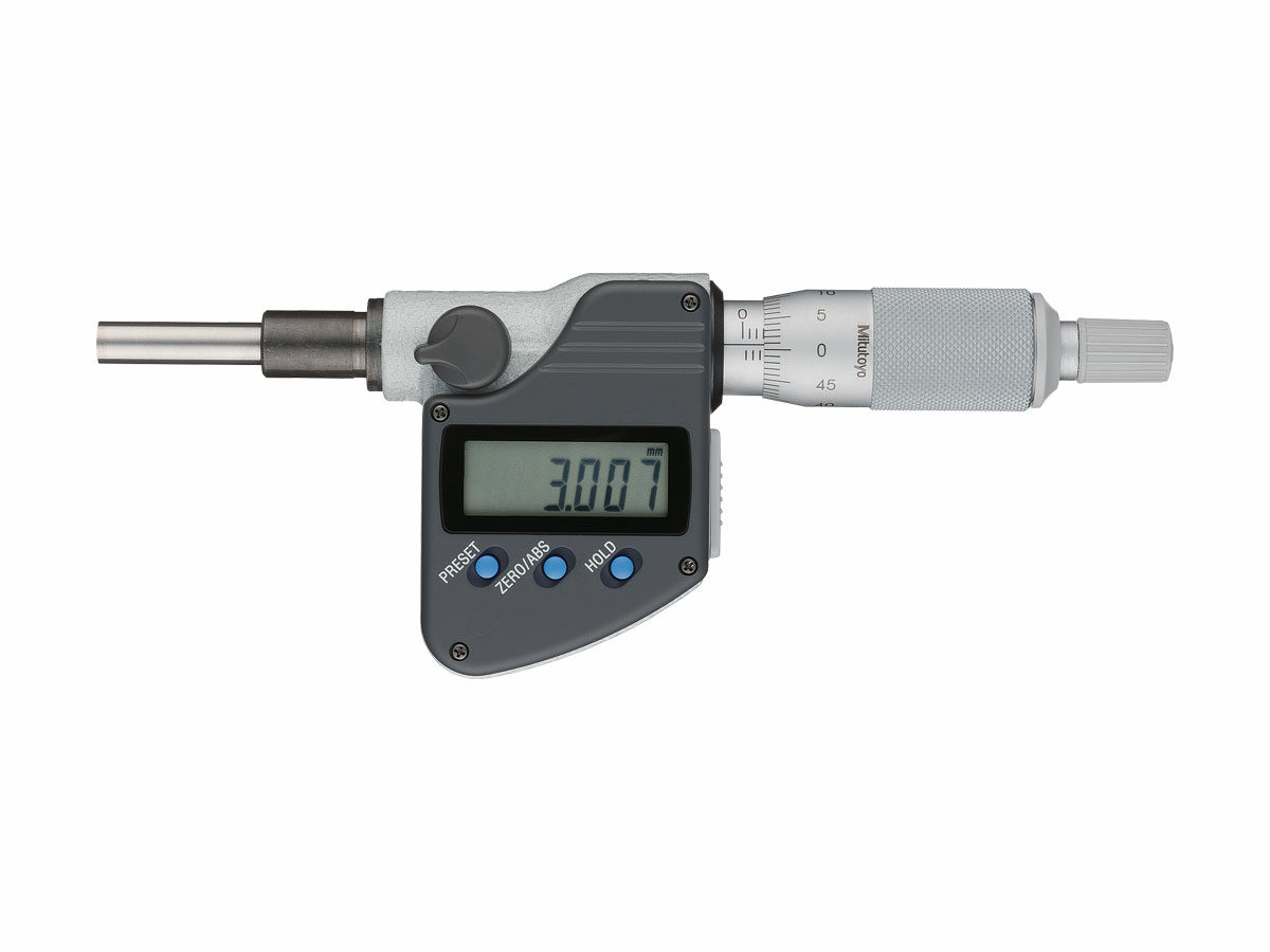

Digimatic Micrometer Heads offer you a perfect integration into machinery and measuring instruments where measurements are displayed on an easy-to-read LCD readout. Eliminate radial torsion on your workpiece with a non-rotating spindle tip (select models).
The Mitutoyo Digimatic digital micrometer head is manufactured with the same precision and durability as our trusted micrometers in our own Japanese factory. The frame and spindles on Mitutoyo’s micrometer heads are constructed of special hardened steel that minimizes flex and fluctuations due to temperatures for better, repeatable accuracy. The ratchet thimble provides a constant measuring force on the spindle to ensure accurate, repeatable measurements.

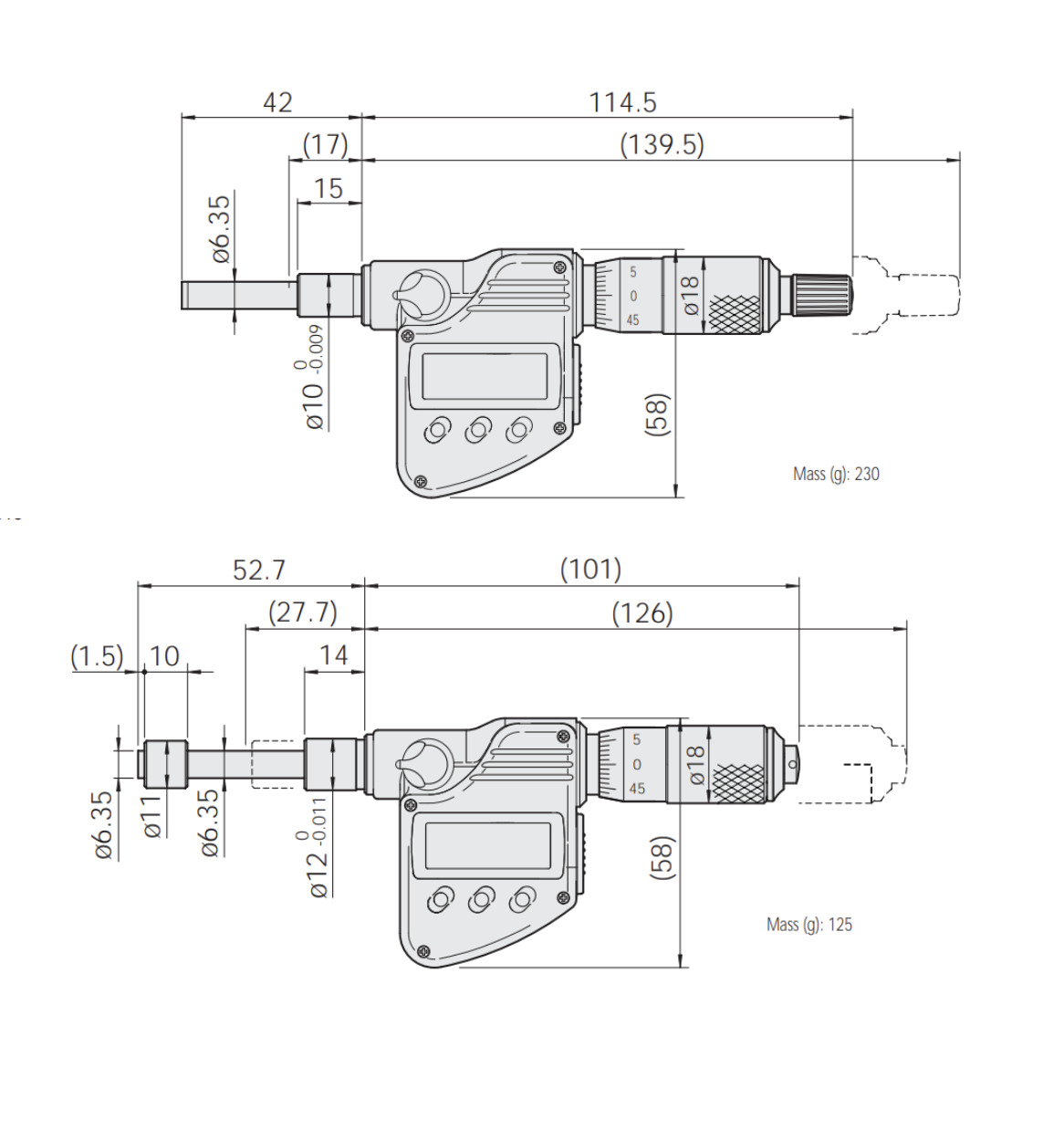

  • Spindle diameter is 6.35mm /.25”
  • Mic head total length (at stroke end) is 181.5mm / 7.15”
