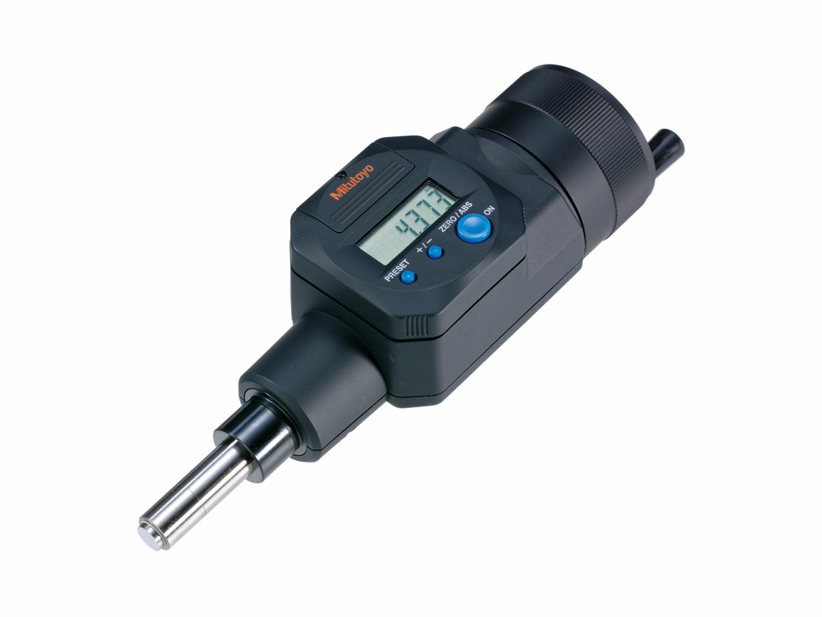

The Mitutoyo digimatic digital micrometer is designed to deliver accurate, repeatable stage movements or stroke measurements. Its display rotates 330 degrees for easy reading in any position.
The Mitutoyo Digimatic digital micrometer head rotates up to 330 degrees for reading in any position, making this micrometer head ideal for small microscope and precision tool set ups. The non-rotating spindle eliminates radial torsion on a workpiece surface and the spindle, providing  accurate results that are easier to achieve. The ratchet thimble provides a constant measuring force on the spindle to ensure accurate, repeatable measurements.
  • Available in Metric and Inch / Metric models
  • Spindle diameter is 11mm / .433”
  • Mic head total length (at stroke end) is 181.5mm / 7.15”
  • Measurement results are displayed with an LCD readout that rotates 330 degrees
  • Functions include Zero Setting, Data Hold, Data Output, Preset, and inch/mm conversion (on inch/metric models only)
  • Twice as long battery life than previous models improves throughput and efficiency
  • Auto power ON/OFF function saves battery life and allows easier use
  • Supplied in a plastic, fitted case
