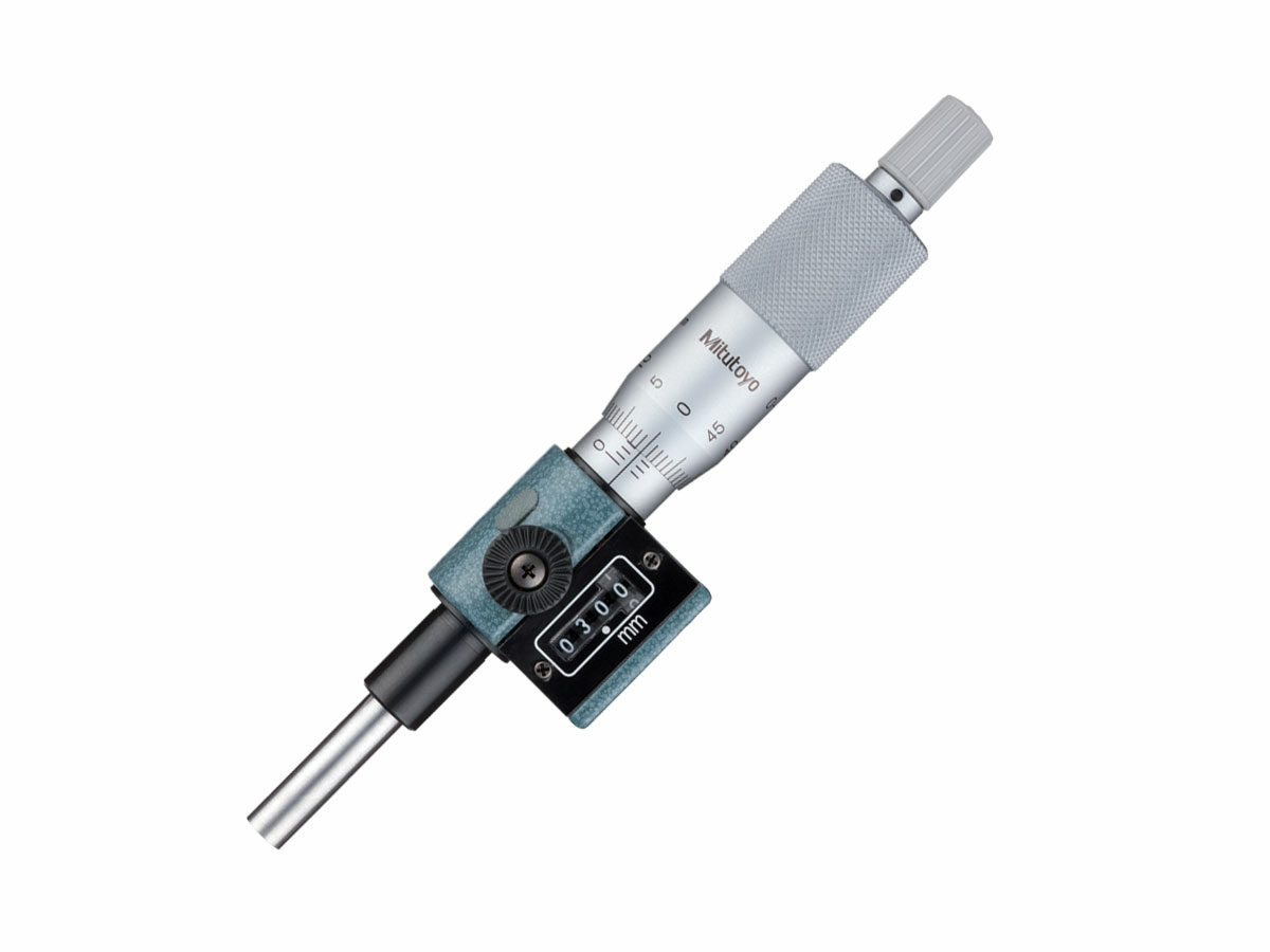

The Mitutoyo micrometer head with digit counter makes reading spindle movements easier without sacrificing accuracy.
The mechanical digit counter on the Mitutoyo Series 250 micrometer head displays spindle displacements numerically that is easy to see when working. The micrometer’s ratchet stop mechanism provides a constant measuring force on the spindle to ensure accurate, repeatable measurements. The combination of the ratchet thimble and speeder enables a rapid spindle feed when measuring widely different dimensions and easier one-handed measurements.

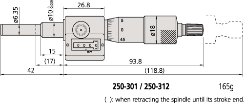

  • Mic head has a 18mm / .71” thimble diameter
  • Spindle range is 25mm / 1”
  • Spindle diameter 6.35mm / .25”
  • Spindle pitch is 0.5mm / .0197” per rev
  • Mic head total length (at stroke end) mm / 6.33”
  • Flat spindle faces are constructed of carbide and have lapped surfaces for more accurate measurements over time
  • Scale is laser etched for easier reading with a hard chrome plating surface that resists corrosion
SERIES 250 Technical Data
Technology: Digit counter
Measuring Faces: Flat (carbide tip)
Scale Surface: Hard chrome plating
Stem: Plain
Mass: 165g
Order No.: Product Image: Units: Range: Accuracy: Graduation: Stem Diameter: Spindle pitch: Remarks:
250-301 Metric 0-25mm ±2µm 0.01mm 10mm 0.5mm -
250-312 Inch 0-1" ±0.0001" 0.0001" 0.375" 0.025" w/vernier
