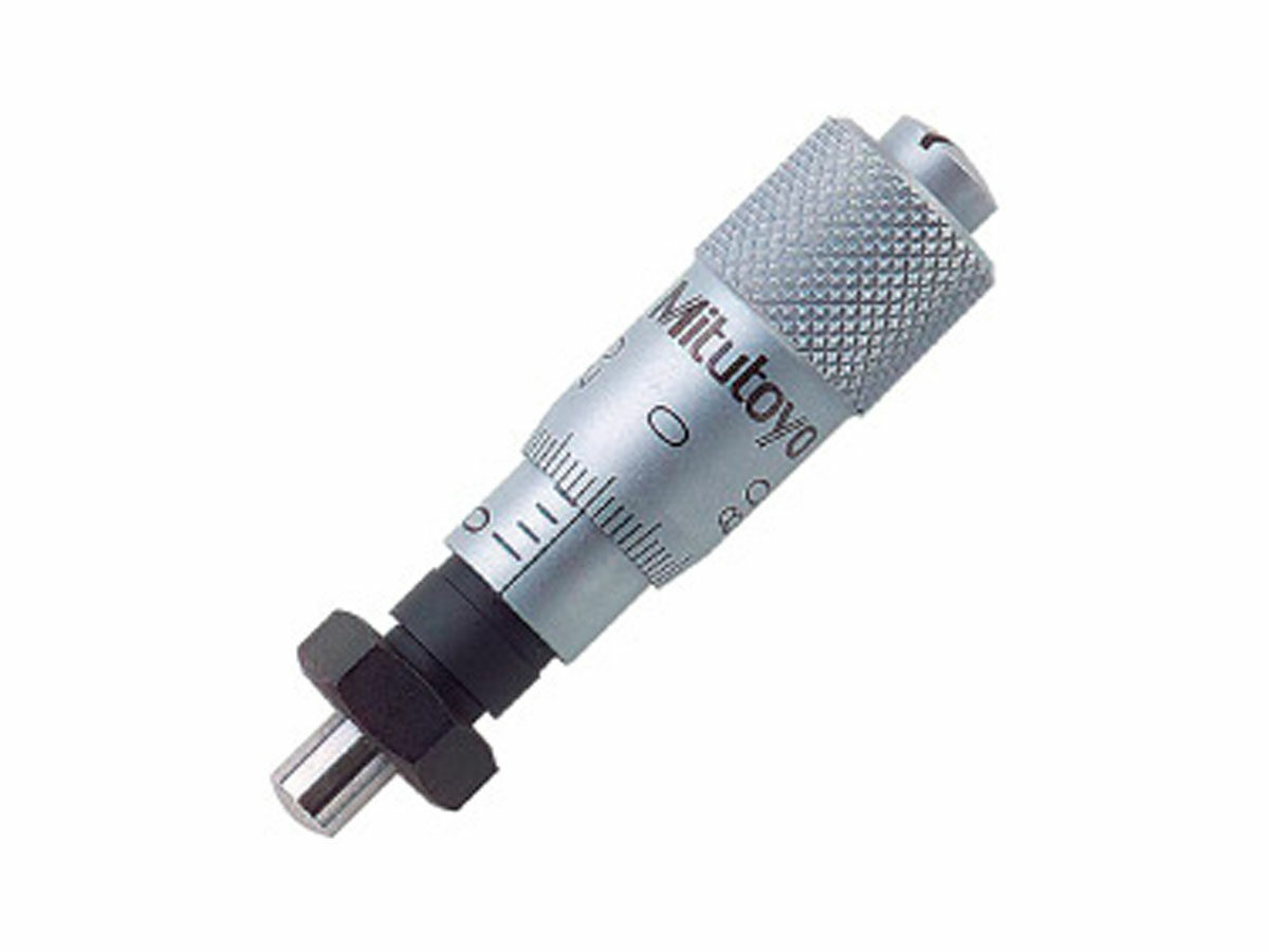

The Mitutoyo fine spindle feeding micrometer head with 0.1mm/rev is ideal for extra-fine adjustments and positioning of a work stage, parts holder or machine.
The Mitutoyo micrometer head with fine-feeding spindle is constructed of hardened tool steel, and the measuring face is precision lapped for better accuracy. The thimble extends at a much smaller rate, 0.1mm per revolution, than conventional micrometer heads for more precise positioning and measurement.
  • Models are available with 6mm or 9.5mm mounting stem diameters
  • Spindle diameters available are 6.35mm / .25″, 5mm /.197″, and 3.5mm /.137″
  • Mic head total lengths (at stroke end) are 43.4mm / 1.70″, 48.5mm / 1.90″, and 61.5mm / 2.42″
  • Spherical spindle faces have lapped surfaces and are constructed of ultra-hard SKS3 steel
  • Thimble is hard-chrome plated with laser-etched scales for easy-to-read measurements
  • External dimensions are compatible with conventional 0.5mm pitch threads
  • Spindle screw threads are precision machined for incredibly precise movements

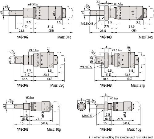

SERIES 148 Technical Data
Technology: Mechanical
Units: Metric
Range: 0-6.5mm
Graduation: 0.002mm
Spindle pitch: 0.1mm
Scale Surface: Hard chrome plating
Order No.: Product Image: Accuracy: Mass: Measuring Faces: Stem Diameter: Stem: Remarks:
148-142 ±2µm 31g Spherical (SR4) 9.5mm Plain -
148-143 - ±2µm 34g Spherical (SR4) 9.5mm w/clamp nut -
148-242 ±5µm 10g Spherical (SR3) 6mm Plain Small thimble diameter
148-243 ±5µm 10g Spherical (SR3) 6mm w/clamp nut Small thimble diameter
148-342 ±2µm 29g Spherical (SR4) 9.5mm Plain Thicker & shorter thimble
148-343 ±2µm 31g Spherical (SR4) 9.5mm w/clamp nut Thicker & shorter thimble
