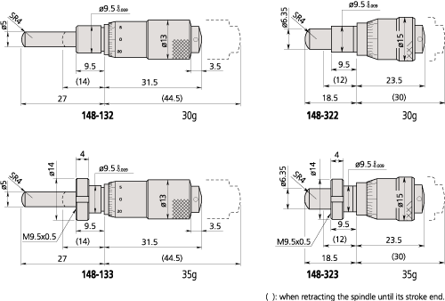

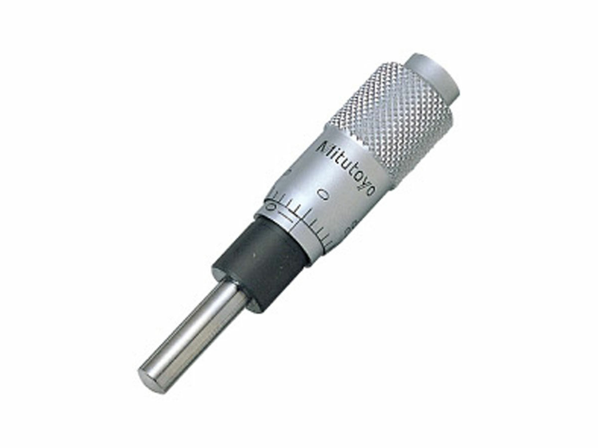

The Mitutoyo fine spindle feeding micrometer head with 0.25mm/rev is ideal for fine adjustments and positioning of a work stage, parts holder or machine.
The Mitutoyo micrometer head with fine-feeding spindle is constructed of hardened tool steel, and the measuring face is precision lapped for better accuracy. The thimble extends at a much smaller rate, 0.25mm per revolution, than conventional micrometer heads for more precise positioning and measurement.
  • Models are available with 9.5mm mounting stem diameters
  • Spindle diameters available are 6.35mm / .25” and 5mm / .197”
  • Mic head total lengths (open) are 48.5mm / 1.90” and 71.5mm / 2.81”
  • Spherical spindle faces have lapped surfaces and are constructed of ultra-hard SKS3 steel
  • Thimble is hard-chrome plated with laser-etched scales for easy-to-read measurements
  • External dimensions are compatible with conventional 0.5mm pitch threads
  • Spindle screw threads are precision machined for incredibly precise movements
SERIES 148 Technical Data
Technology: Mechanical
Units: Metric
Accuracy: ±2µm
Graduation: 0.01mm
Measuring Faces: Spherical (SR4)
Stem Diameter: 9.5mm
Spindle pitch: 0.25mm
Scale Surface: Hard chrome plating
Order No.: Product Image: Range: Mass: Stem:
148-132 0-13mm 30g Plain
148-133 - 0-13mm 35g w/clamp nut
148-322 - 0-6.5mm 30g Plain
148-323 - 0-6.5mm 35g w/clamp nut
