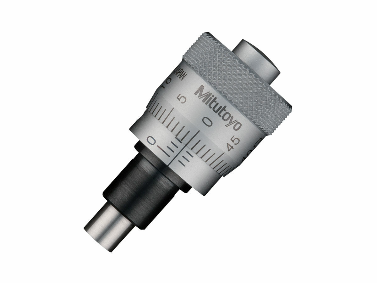

The Mitutoyo large thimble diameter micrometer heads allow easier measurement reading, even in confined spaces.
The Mitutoyo large thimble diameter micrometer heads provide highly accurate measurements and adjustments that are easier to read. The spindle is constructed of hardened tool steel, and the measuring face is precision lapped for better accuracy.
  • Mounting stem diameter is 9.5mm / .375”
  • Spindle diameter is 6.5mm / .256”
  • Mic head total lengths (at stroke end) are 48.5mm / 1.90” and 68mm / 2.67”
  • Three types of thimble diameters are available for each Metric and Inch models
  • Spindle faces are flat and have lapped surfaces and are constructed of ultra-hard SKS3 steel
  • Thimble is hard-chrome plated with laser-etched scales for easy-to-read measurements
  • Spindle screw threads are precision machined for incredibly precise movements

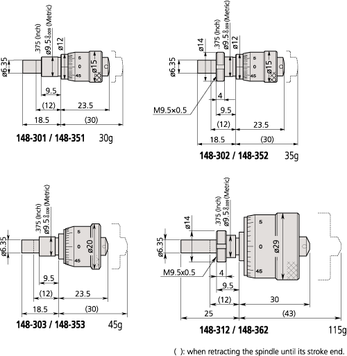

SERIES 148 Technical Data
Technology: Mechanical
Measuring Faces: Flat
Scale Surface: Hard chrome plating
Order No.: Product Image: Units: Range: Accuracy: Graduation: Stem Diameter: Stem: Spindle pitch: Thimble diameter:
148-301 Metric 0-6.5mm ±2µm 0.01mm 9.5mm Plain 0.5mm 15mm
148-302 - Metric 0-6.5mm ±2µm 0.01mm 9.5mm w/clamp nut 0.5mm 15mm
148-303 Metric 0-6.5mm ±2µm 0.01mm 9.5mm Plain 0.5mm 20mm
148-304 - Metric 0-6.5mm ±2µm 0.01mm 9.5mm w/clamp nut 0.5mm 20mm
148-305 Metric 0-6.5mm ±2µm 0.01mm 9.5mm Plain 0.5mm 29mm
148-306 - Metric 0-6.5mm ±2µm 0.01mm 9.5mm w/clamp nut 0.5mm 29mm
148-307 - Metric 0-13mm ±2µm 0.01mm 9.5mm Plain 0.5mm 15mm
148-308 - Metric 0-13mm ±2µm 0.01mm 9.5mm w/clamp nut 0.5mm 15mm
148-309 - Metric 0-13mm ±2µm 0.01mm 9.5mm Plain 0.5mm 20mm
148-310 - Metric 0-13mm ±2µm 0.01mm 9.5mm w/clamp nut 0.5mm 20mm
148-311 - Metric 0-13mm ±2µm 0.01mm 9.5mm Plain 0.5mm 29mm
148-312 - Metric 0-13mm ±2µm 0.01mm 9.5mm w/clamp nut 0.5mm 29mm
148-351 Inch 0-0.25" ±0.0001" 0.001" 0.375" Plain 0.025" 0.59"
148-352 - Inch 0-0.25" ±0.0001" 0.001" 0.375" w/clamp nut 0.025" 0.59"
148-353 - Inch 0-0.25" ±0.0001" 0.001" 0.375" Plain 0.025" 0.79"
148-354 Inch 0-0.25" ±0.0001" 0.001" 0.375" w/clamp nut 0.025" 0.79"
148-355 Inch 0-0.25" ±0.0001" 0.001" 0.375" Plain 0.025" 1.14"
148-356 - Inch 0-0.25" ±0.0001" 0.001" 0.375" w/clamp nut 0.025" 1.14"
148-357 - Inch 0-0.50" ±0.0001" 0.001" 0.375" Plain 0.025" 0.59"
148-358 Inch 0-0.50" ±0.0001" 0.001" 0.375" w/clamp nut 0.025" 0.59"
148-359 Inch 0-0.50" ±0.0001" 0.001" 0.375" Plain 0.025" 0.79"
148-360 - Inch 0-0.50" ±0.0001" 0.001" 0.375" w/clamp nut 0.025" 0.79"
148-361 - Inch 0-0.50" ±0.0001" 0.001" 0.375" Plain 0.025" 1.14"
148-362 Inch 0-0.50" ±0.0001" 0.001" 0.375" w/clamp nut 0.025" 1.14"
